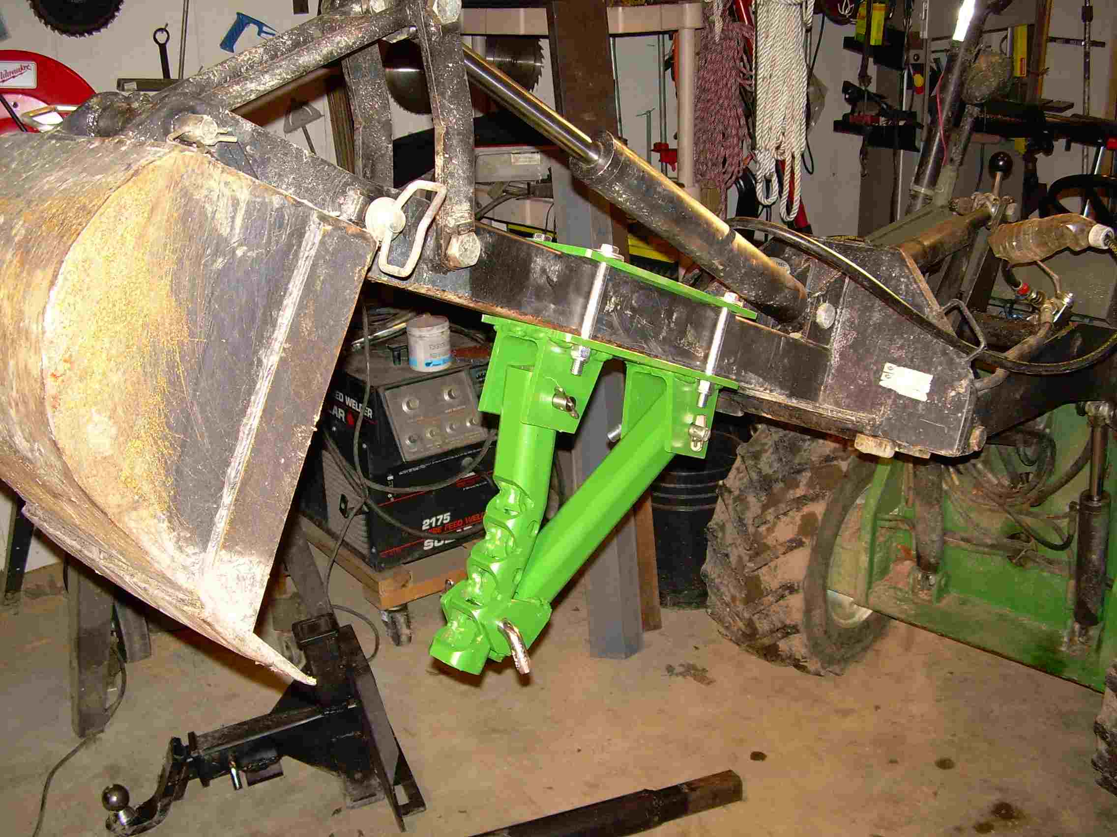

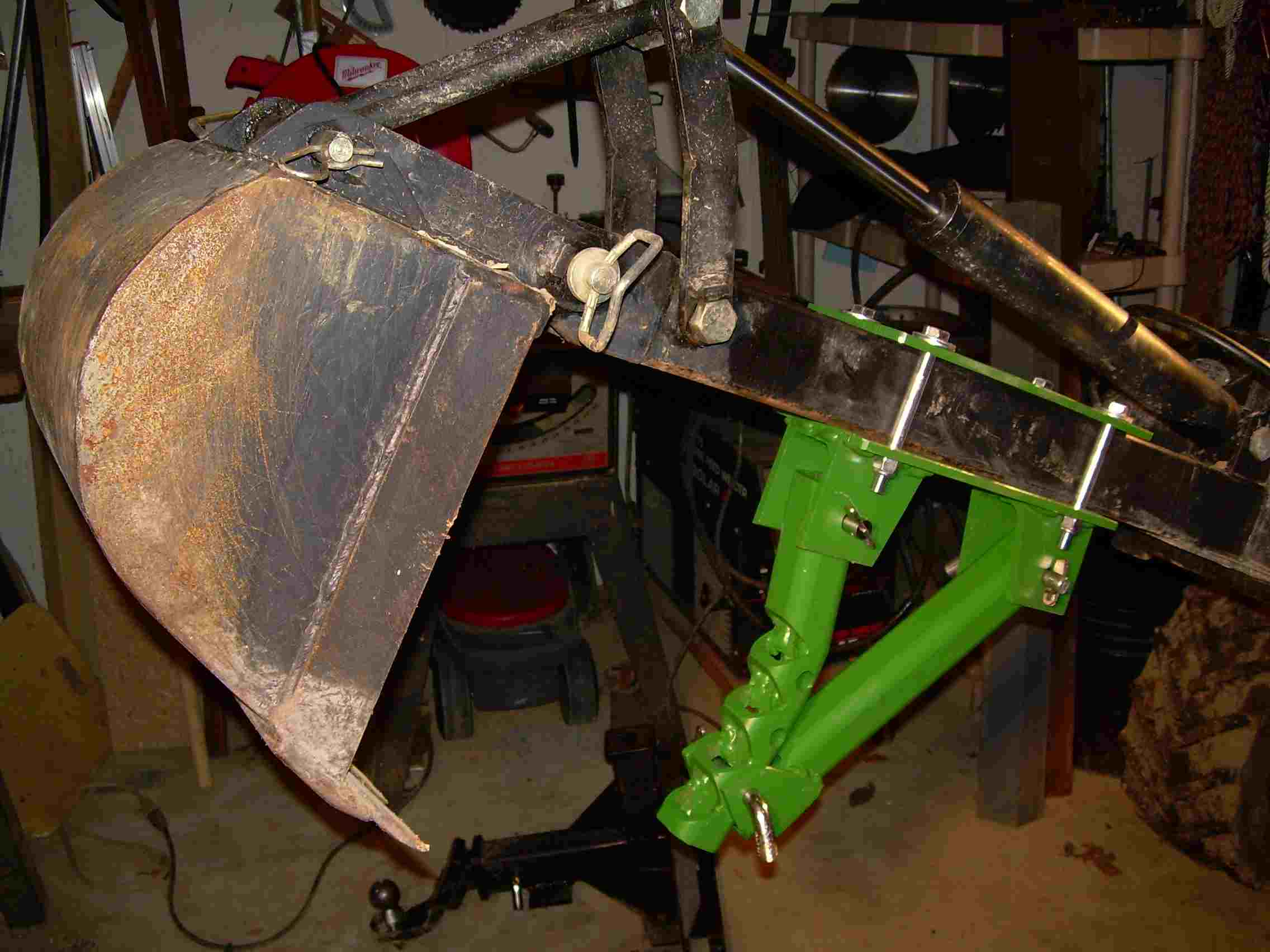

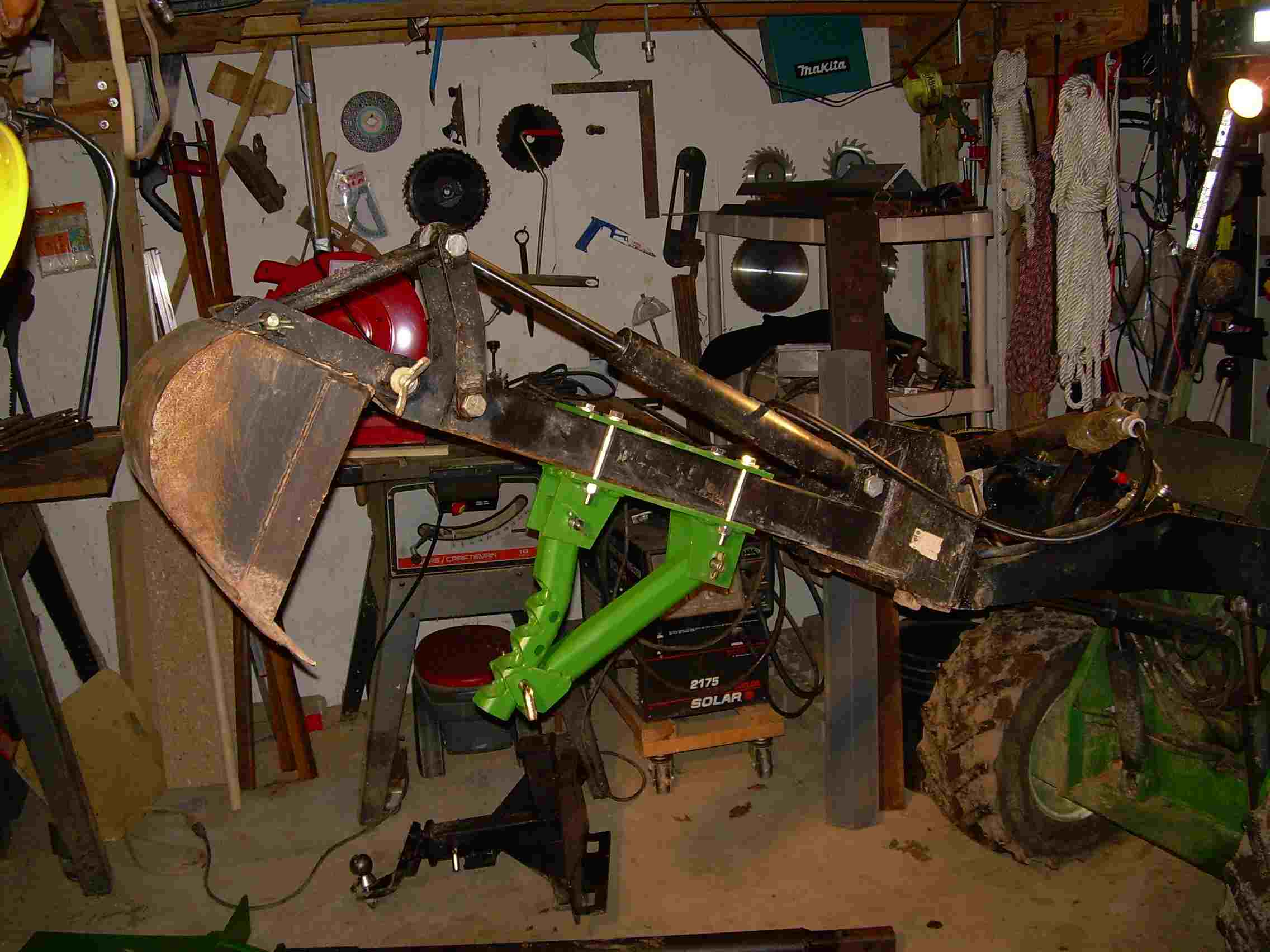

I though I would attach some final pictures of the painted thumb. I have not used it since painting so it is still clean.

Wow! ... Great work BobRip! ... real craftsmanship, nice paint job too, ... thanks for sharing this project with everyone, you made us all proud!

Thanks JD, as my tools get better the projects get better. Still need to work on the welding. My tools are OK here, I just need to develop some skill.
I am still waiting for some unusual or new uses for the thumb.
