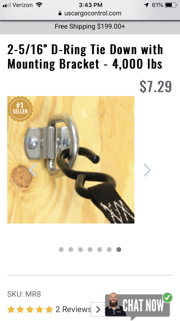

I was planning on doing theses. Using washers with nuts on bottom side of trailer to secure a UTV. Is there a issue with this setup? Easy to do and no welding. Thoughts?
I use them to keep a big plastic box in one place on my utility trailer. The box is the size of larger cooler and has my chains and binders in it. When all the stuff is in it, I can't move it by hand. These are just screwed into the wood decking. On another trailer I have these bolted through the metal frame to secure my Gravely walk behind. Again not a lot of weight. Jon
   / Tie down options for utility trailer with sides #20
Seems to me that going through 1.5”thick boards using 7/16” bolts to secure a 1600lb utv would be a piece of cake. I just can’t see the bolts not holding but several people said they don’t trust that setup.
