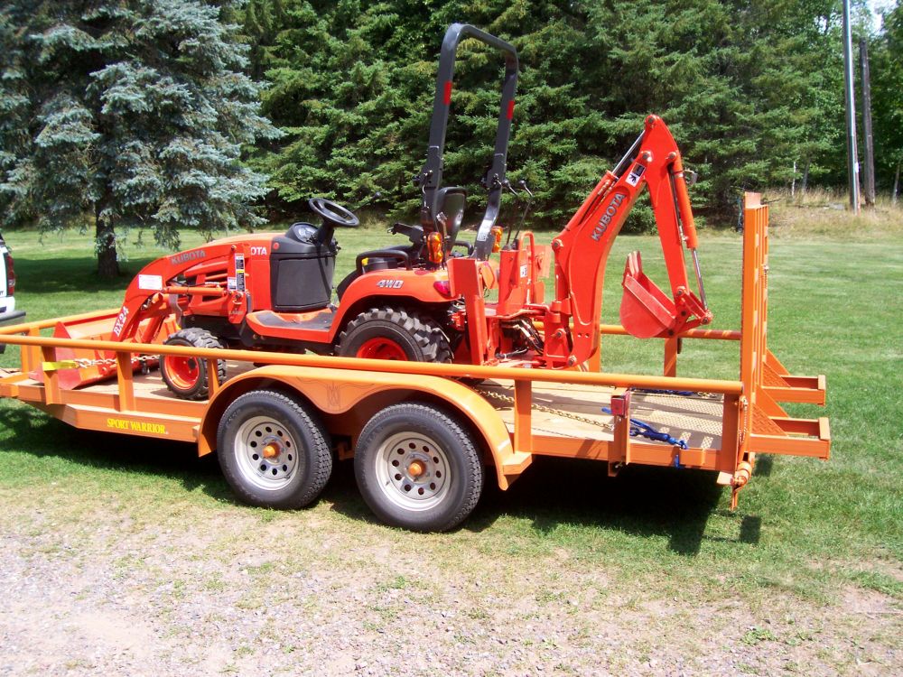

I like Firefighter Kubota use a combo of both. My biggest problem with straps is that they loosen during my trip. My chains with the foldable tie downs always hold my tractor still. You can never be too careful! Nothing will ruin your day like seeing your new 24 on it's side in a ditch because grandma didn't see you coming!

I use chains with ratchet binders on all 4 corners and a strap over the FEL bucket.

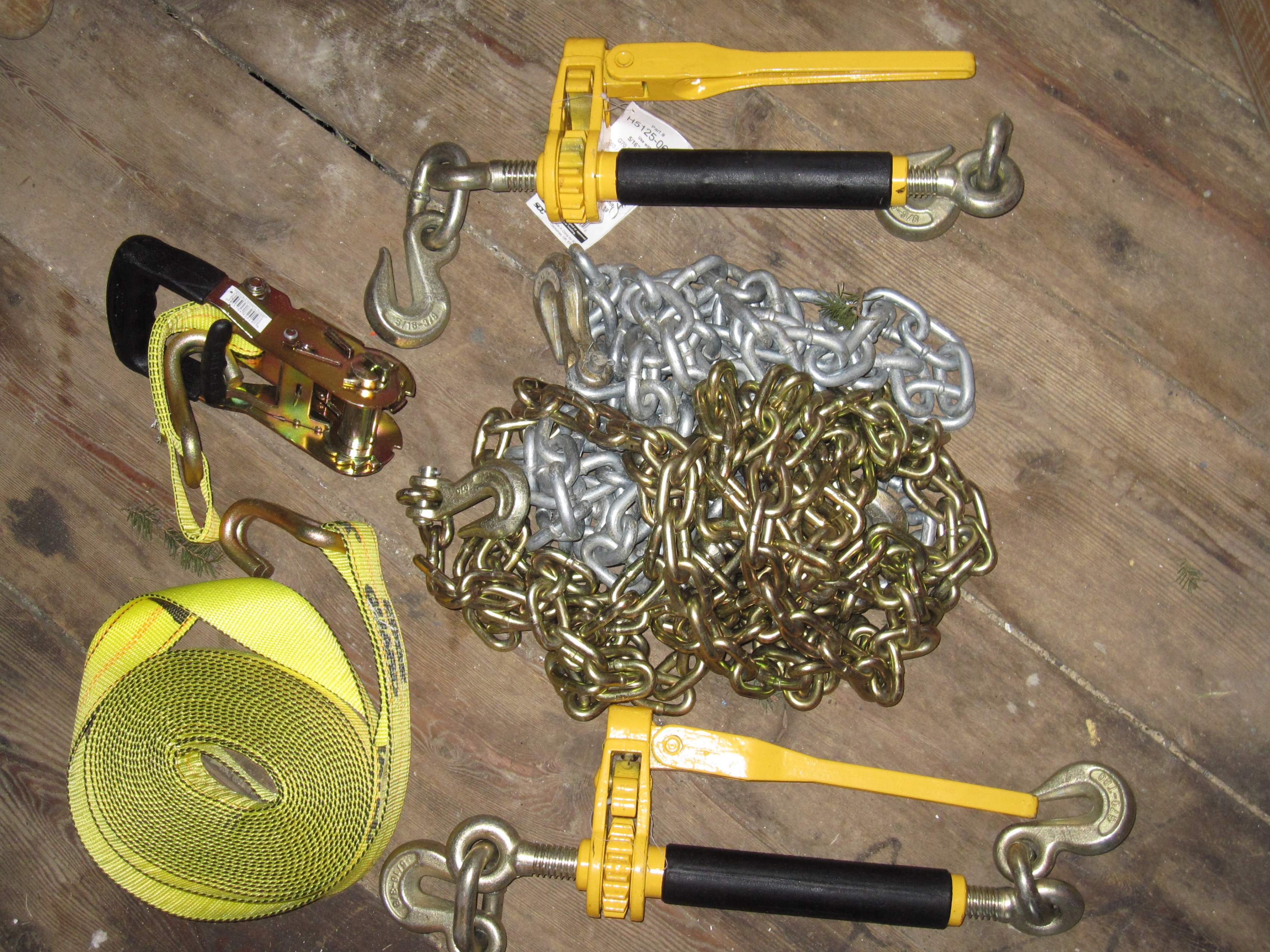

Tie Down

On my BX, I use the 3" 10,000 lb rated ratchet straps. I have never had one loosen up, all of mine are less then 3 yrs old and I check for frays when attaching. My BX has no backhoe, so it is a bit lighter and I don't feel chains are necessary. We use chains and binders on all the heavier equipment, but I feel the straps are fine for the BX and they don't scratch it all up.
I would not use those 1500-3000 lb ATV straps.....I use 4 of those on an ATV, but the ATV is under 600 lbs, the BX is about 1800 I think....yours is quite a bit more I bet.

Again , you can get by with those until something goes wrong...
the 3500# straps are working load and a BS 7000#
and the 5000# BS of 10000...
If you use 4 of your straps on a 3000 machine each strap is caring 50% of its working load... Safe until you loose a strap, get hit etc...
The 10000# bs straps are $22 each....worth the cost and save your 1500 for the atv's,

For a little BX I would go get 4 2" yellow straps that have a working load of like 3,300 lbs and breaking of 10k put one on each corner any you will be set, TSC had them on sale last week & I bought 4 packs of 2 each for $27 each package, as I feel you can never have enough straps.
Yes chain works also but its hard to handle on these little BX's
We use chain on a B26 and all the big equipment, but most of the attachments we use straps and some of them weigh more than your BX.
