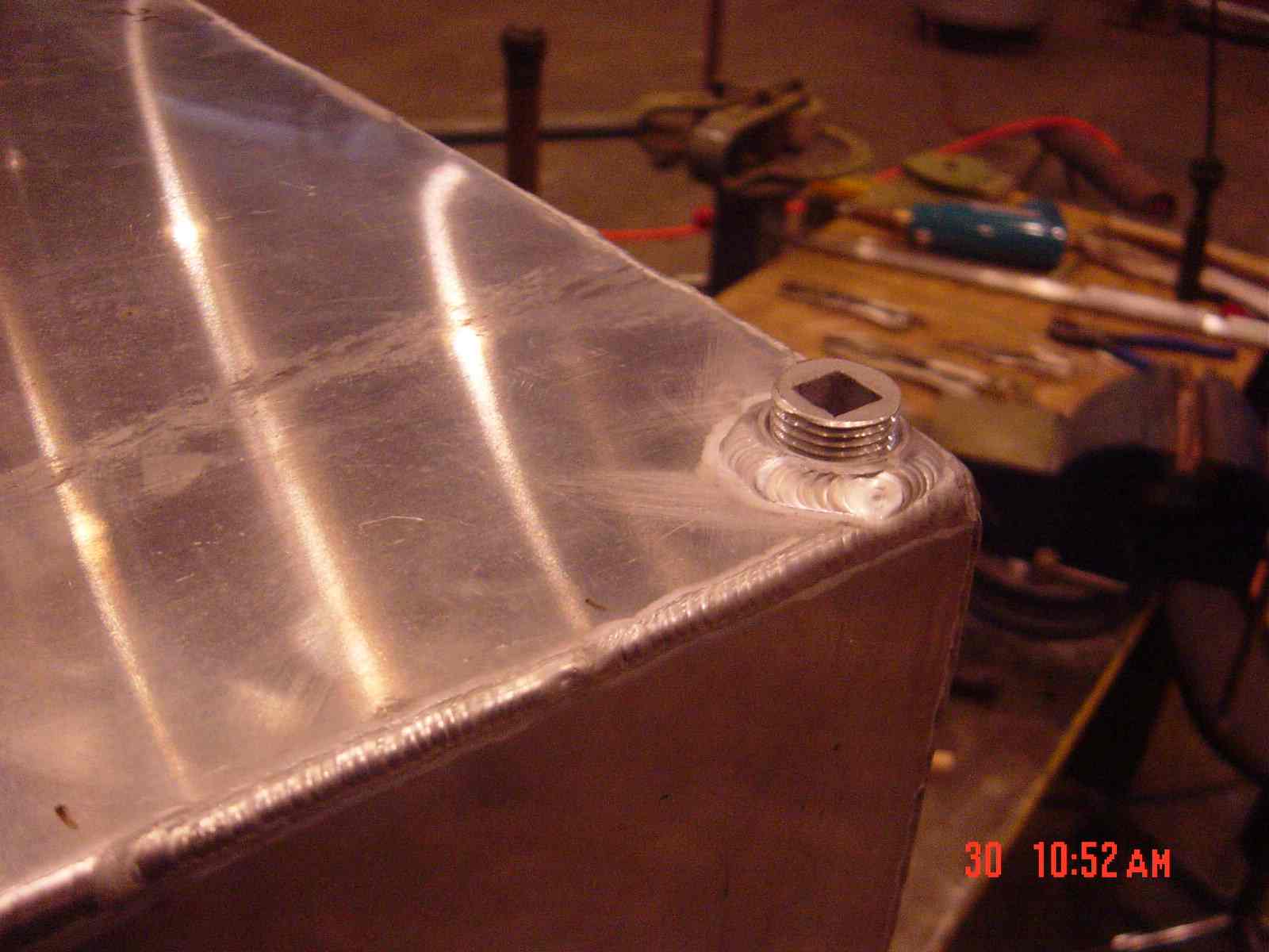

If you want to get into Tig on the cheap, for under $200.00 Less the argon bottle. Get a scratch start, air cooled Tig rig, flow meter, and consumables. I just helped a kid on another site with this setup, and he runs it on his Hobart Stickmate. If you get good with one of these, when you get a Tig machine with pedal you'll think you've died and gone to heaven.;)

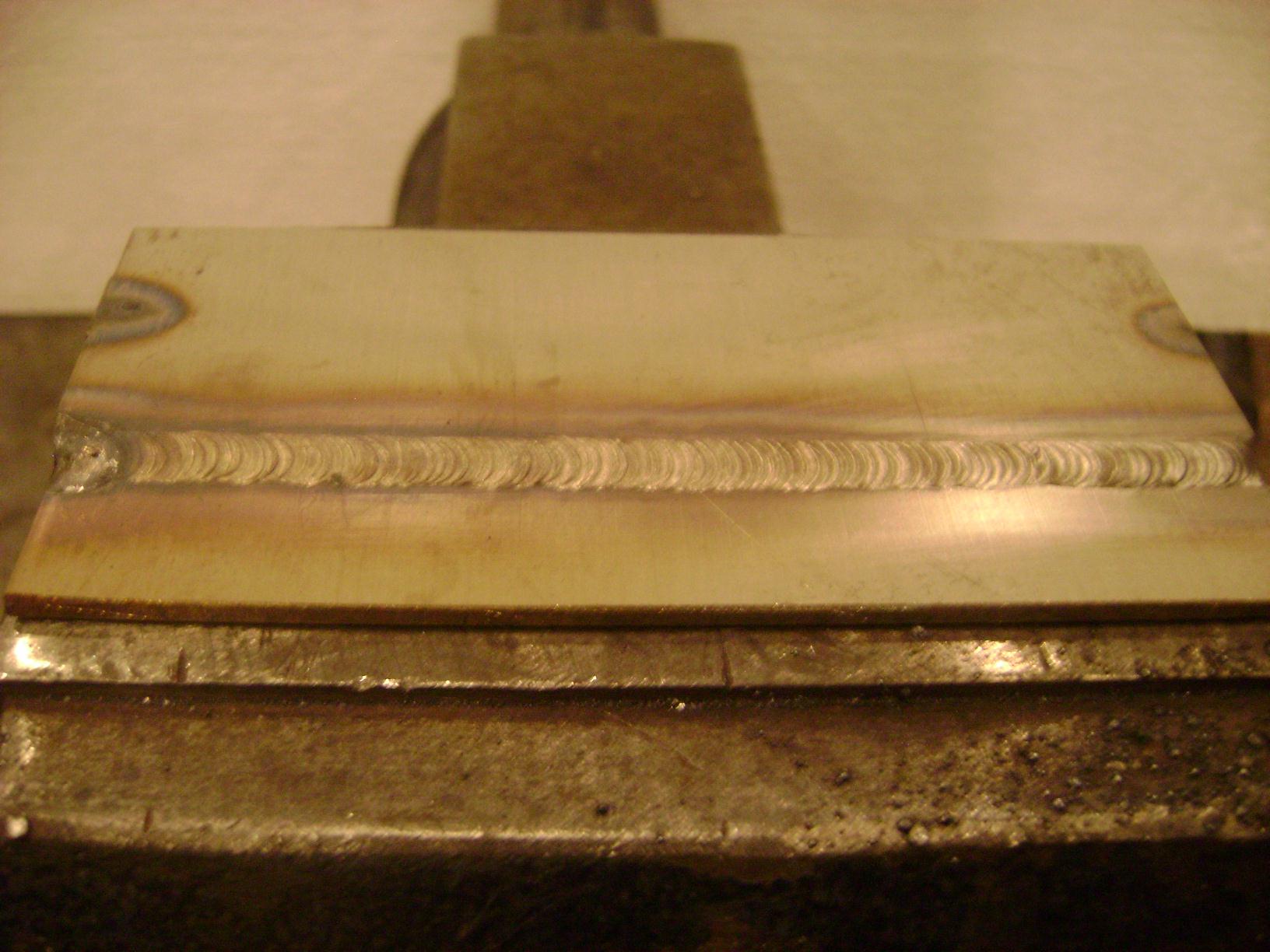

Here's a stainless steel Tig weld I made with my Everlast PowerArc 200 and my Tig rig, and I'm nowhere near a Tig weldor! :eek:
