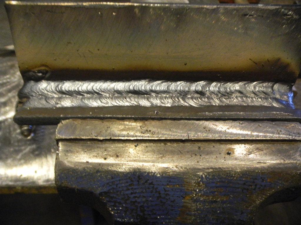

Tig break test.

To rankrank1 I have to admit that I have no idea what you are talking about other than that it probably relates to sticking your rod when starting an arc. I only ever cared about duty cycle and in the range where I'll be doing most of my repairs it is around 50 to 60% which is good enough for me. I'm not a professional welder and don't do structural welding but I have been using welders for 30 plus yrs and when I repair a piece of farm equipment it stays fixed. I'm going to pay attention to how often my rod sticks while I'm getting used to using it. In the future I'm going to pay attention to the numbers you've mentioned and see how the different welders compare. Obviously it will explain why some machines are so cheap and why you pay more for top of the line machines.
It's pretty darn hot out today and taking pictures will be enough to work up a sweat so maybe I'll get them for Deereman.
