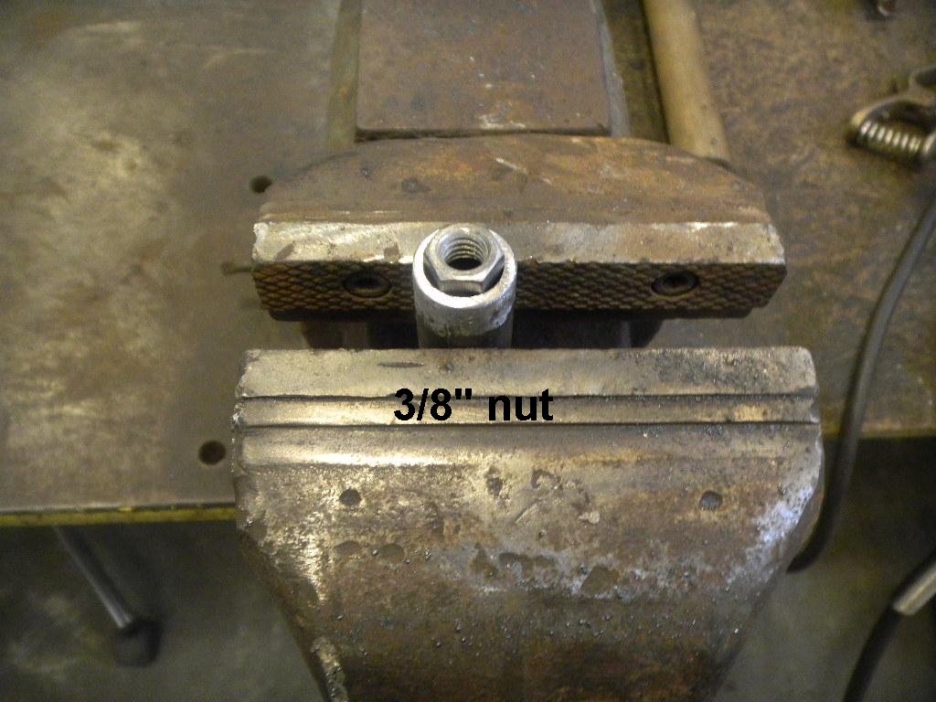

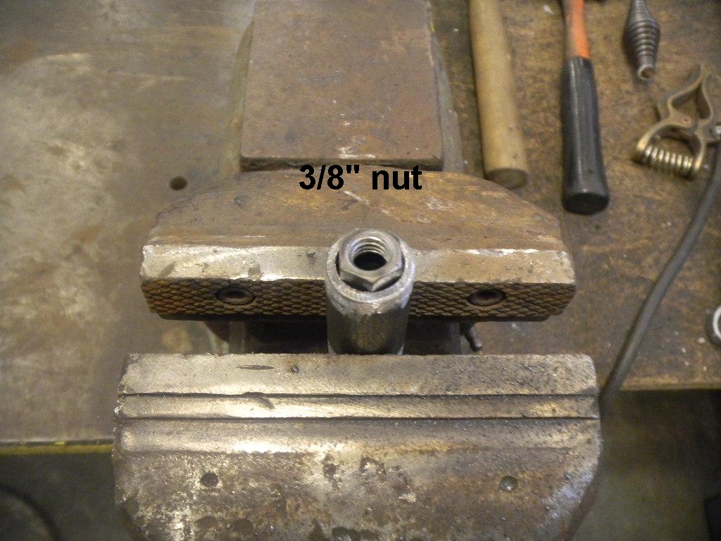

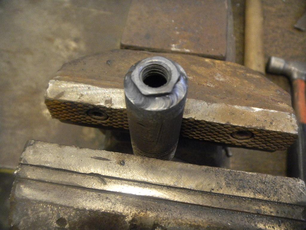

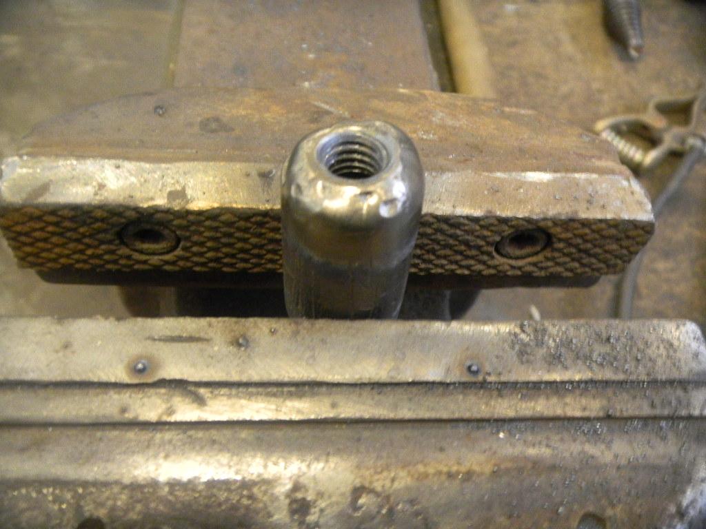

Here is some Tig welds I made with my PowerArc 200ST.
