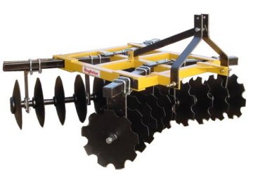

Yes, I'm going with a Landpride disk harrow. Will be easier to do firebreaks, etc.
/ Tiller or Disk harrow? #9
I've put a few hours on the tractor with the 3pt. disc harrow now and really like the job it does. I spent an hour this morning working an area about 100' x 75' for a friend so he could plant grass. His yard was un-even and had poor grass coverage. I started with the disk cutting aggressively by shortening the top link. After one pass like that, I lengthened the top link so the disk was level or maybe even a hair lower in the back and worked the ground again cutting very shallow. This made for a powder smooth finish; I was more than impressed.
My disc is weighs about 700 lbs. You should be pleased with "Land pride"
