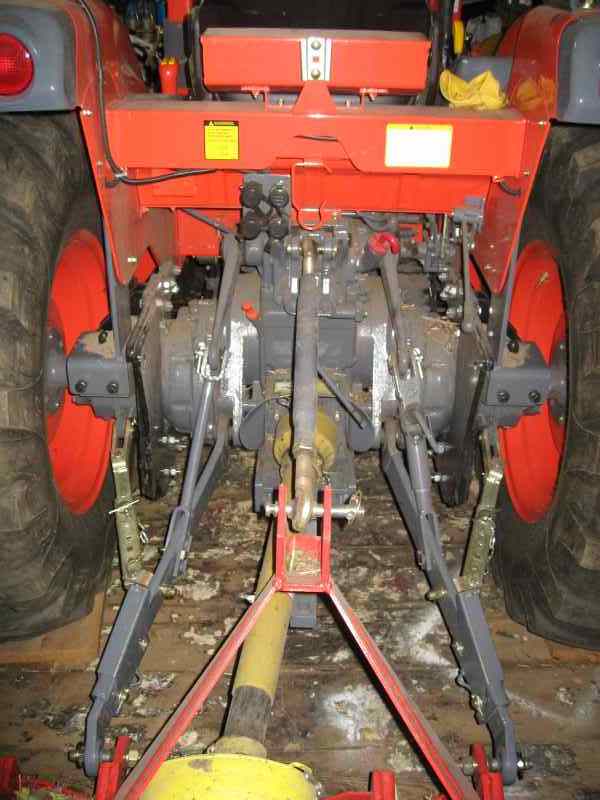

Thanks for all of the replies! As far as rear remotes, I think I have one, but, remind me, what do they look like again? I believe they guy we bought from mentioned there was one.

Look for two female 1/2 inch quick connects next to each other. 1/2 inch refers to the tubing, the quick connects themselves look just like the ones on the loader. About an inch by three inches. You should also have a remote valve lever typically within easy reach of your right hand while seated.
Photo shows four (two sets) with black caps just above and to the left of the topping link tractor attachment point.

Thanks for the picture and the great explanation. We do have 2 of those (one set), so we must have one remote - we do have a lever easily accessible by my right hand.

Installing 2 remotes as we speak, was going to ask for pictures so I'll know if I installed them the right way.
Now for the stupid question of the day: I can hook up lines by just pushing them in but, how do get them out ?
Stock Kubota remotes are inclosed in a steel housing, couplings sit flush with the face.

In I can hook up lines by just pushing them in but, how do get them out ?
Grasp the connector and slide the round brass top back (the top will side back) which will release the fitting, you may have to also push the hose forward toward the connection point. Sometimes they require this to connect them and some times they will just click on by pushing them on which they obviously did for you.
