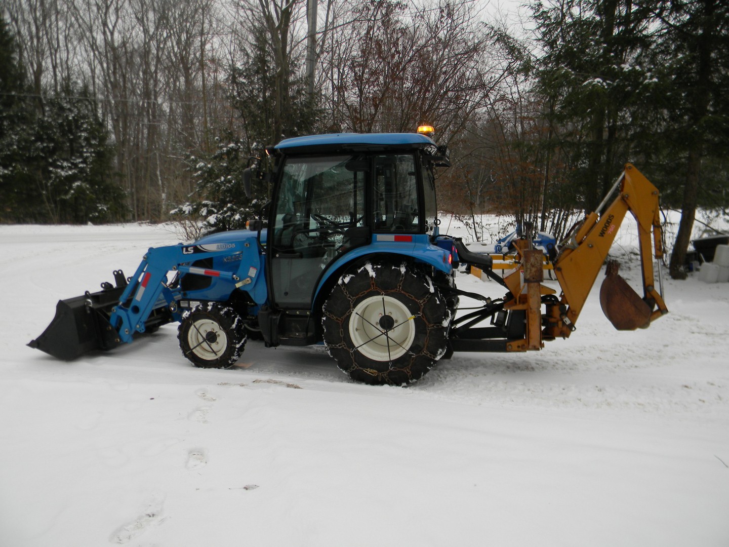

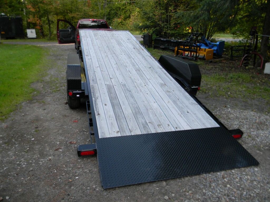

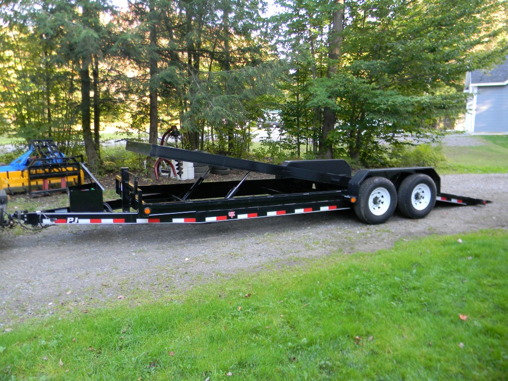

Are you set on buying a goose neck deck over? I have a 14K PJ tag trailer 22' tilt bed (actual 23'9") deck. Deck height is about 22" and very easy to load my LS XR3037HC with loader and BH. (weighs about 7K with loader and BH, similar to your CT450) Lower deck height of mine means I don't have to tilt as high as a deck over and less angle to deal with.

No, the BH has not hit but I've only loaded it on (and off) 3 times with the BH. Didn't have any pics to post with the BH on. I don't do a lot of BH work off my property. Grade on mine is about 12 degrees. I prefer the wood deck over metal. Metal deck is too slippery in winter. I had a metal deck tilt years ago, about broke my neck walking on the tilted metal deck when wet and slipped. Hurt my pride more than anything. Wood seems to have more grip. If you have mud and water no tilt bed deck (wood or metal) will be safe. I have loaded my tractor on the deck when snow covered but I had chains on the tractor so it didn't slip. As you can see from the below pic my BH bucket has decent ground clearance when curled up.

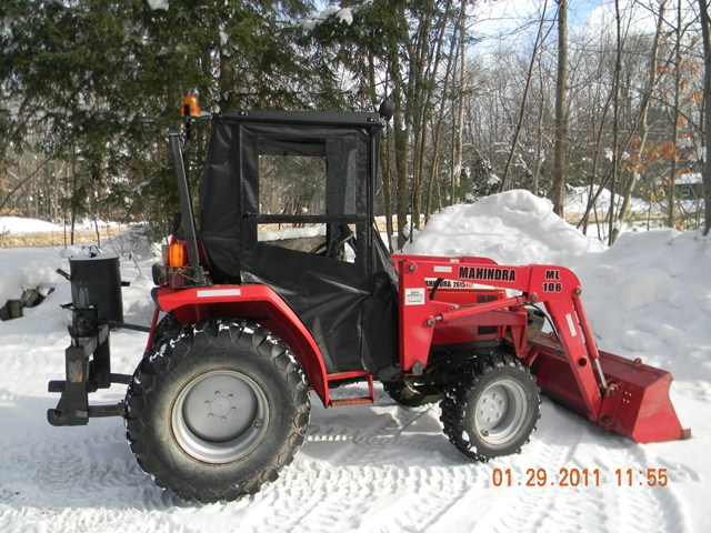

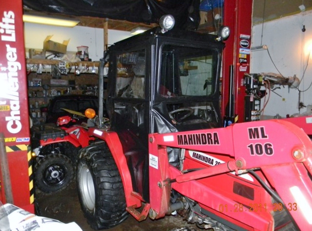

Maybe its time for you to modify a factory made soft cab for your CT. I bought one for my Mahindra 2615HST and added a 12V ceramic heater. At least it kept me out of the cold wind and gave a little heat. Here's the one I put on my 2615.
