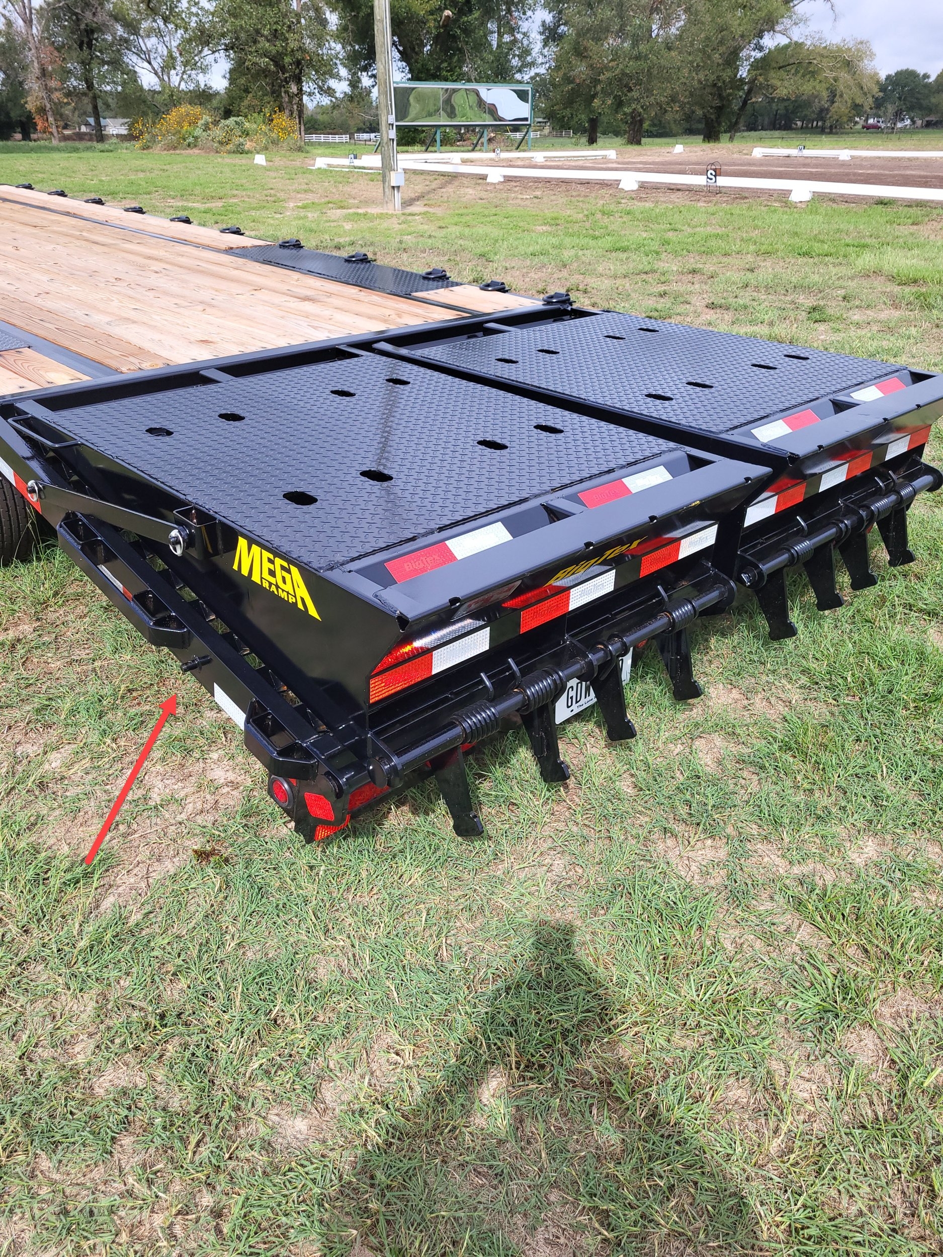

Thanks - do you think without any 3-pt that I’d be ok with the big tex 20+5 mega ramps? 20 feet of deck and 5 feet of ramps folded into deck? 5 feet shorter than yours. It looks like there should be ample space based on the pics?
You will have room with an implement. Mine is the Big Tex 20+5 with Mega ramps, for a total of 25' in length. If the implement prevents the ramps from laying flat after getting the tractor pulled up on the trailer, I would just pin the ramps upright. That is what the pin at the bottom between the rub rails is for.

Oh thank you! I was thinking based on your first message that yours was 30’ long, a 25+5.

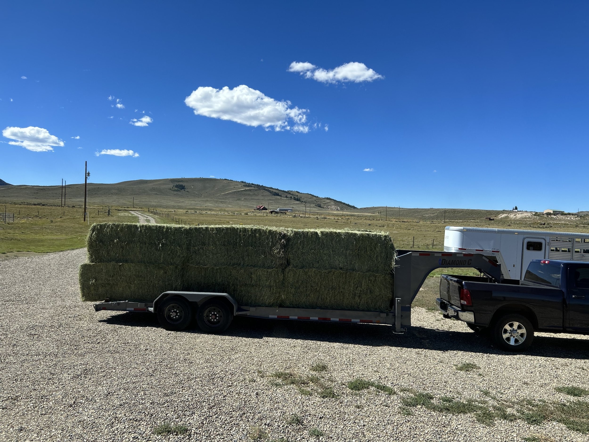

I also want to haul round bales with it. For me, the biggest pain with hauling hay is strapping it down. I don't want to buy a hay trailer, so I'm leaning towards this trailer from Texas Pride with side rails that are 8 feet apart. I think that this will allow me to place the bales inside the rails of the trailer, and haul them without any straps, if I don't stack them.

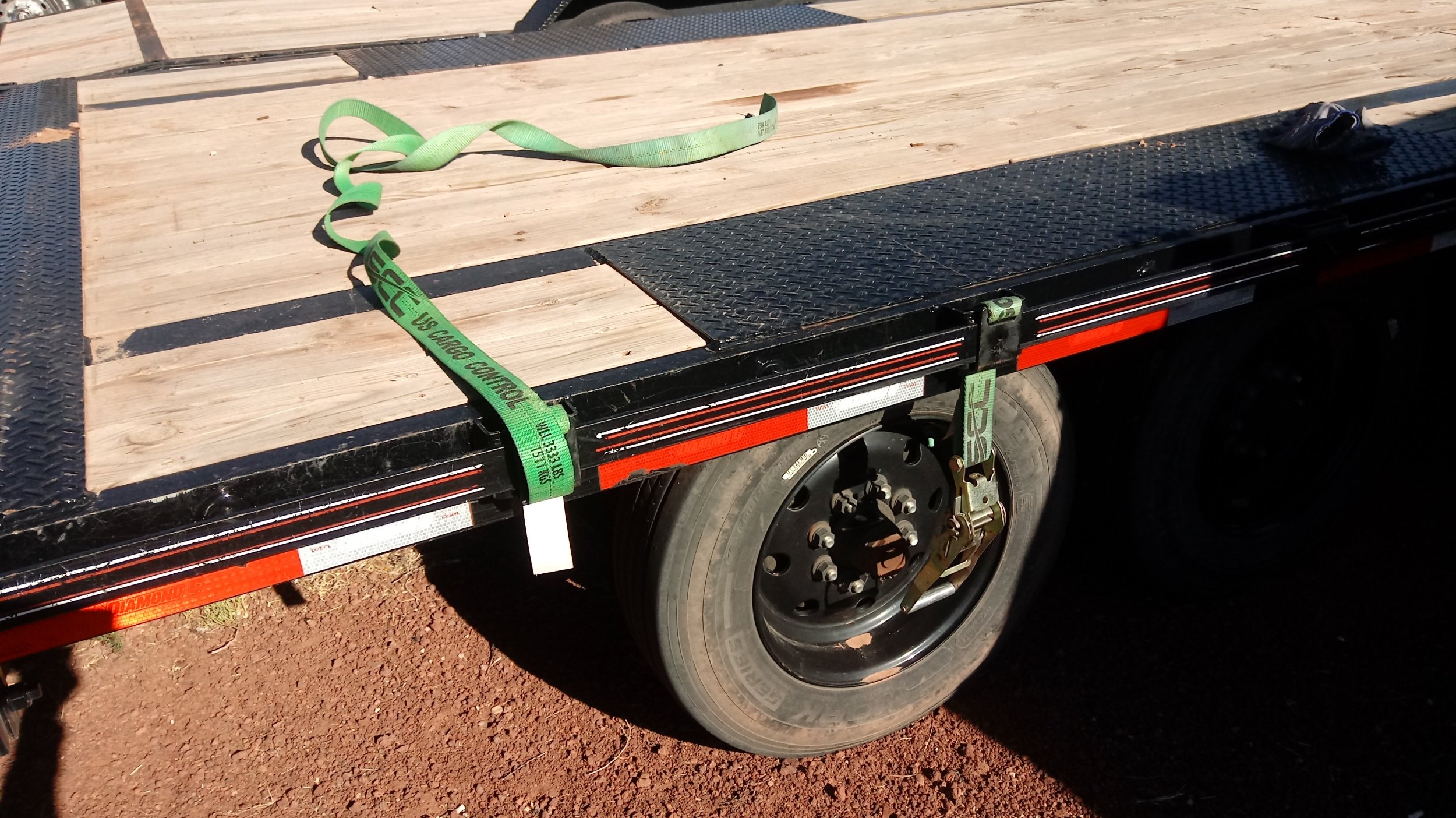

@EddieWalker strapping down takes a couple minutes. I use the few stake pockets or d-rings on mine.
   / Trailer recommendation for a New Holland Workmaster 75 #17
I don't think you can fit 2 4'X5' round bales in between the rails. There is only 6'8" between the wheel wells. Like Stumblinhorse said, strapping down doesn't take long. I put 5,400# WLL d-rings in every stake pocket. My 2" 3,333# WLL straps have twisted snap hooks. That way I can strap the load down by myself without having the far side come loose. If I need something in between I use a 2" 3,333# WLL axle strap around the rub rail standoff support. I switched my 3/8" chains over to G70 hooks with safety latches for hauling equipment, same type hooks that wreckers use for safety chains.

I have a TL80A new Holland with a cab. I do not have a front end loader on it. I do have a twin spindle 96 inch offset Alamo Mower. Actually it’s a rhino mower. I haul it on a big text 25 foot deck with mega ramps for a total of 30 feet. It’s a pretty tight fit. I’m also overweight on the trailer.
I’m not sure the 22 feet would be long enough. Especially if you go to move it with a Bushhog.
My second observation without knowing your age how long will you be able to flip the mega ramps? When I bought the trailer flipping the ramps was no problem. Six years later and having to live in a wheelchair, I struggle with the mega ramps.
I would suggest at least a 25 foot Goose neck and get a hydraulic dovetail if you plan on keeping it for a long time. I know it’s easy to spend somebody else’s money.
Yep, get Longer not shorter. I can't even fit a 5 foot brush hog and my 55 HP tractor completely on a 20 foot and that is with the bucket placed on top of the fifth wheel... Pay a bit more out of the gate and get that extra length.
I like the flat hooks for the most part. I wrap the strap around the hook so it can't come loose, it also provides a more blunt edge v/s the stake pocket when you wrap the hook from the bottom. If you hook at the top and wrap, the strap contacts the sharp edge of the stake pocket.
