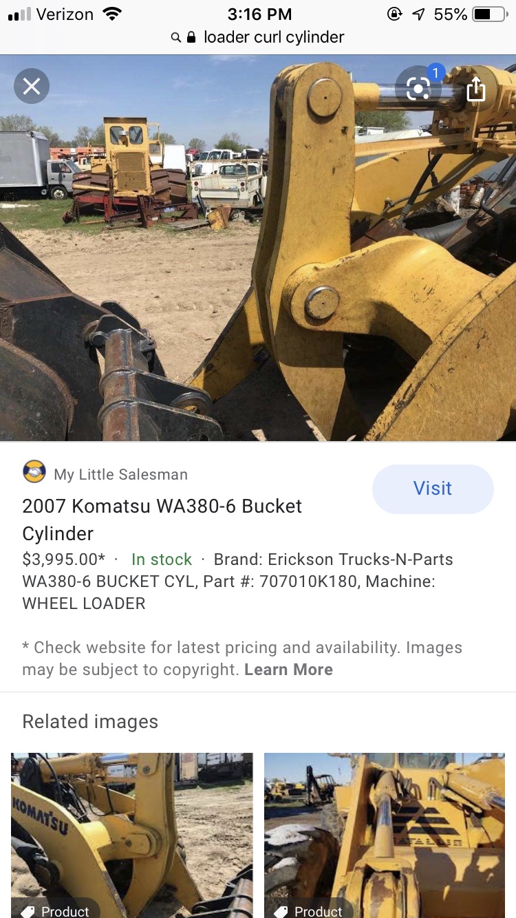

Keep in mind that you ironically have more dump force than curl force when more curl force would be more useful most of the time. The reason is of course its there are more square inches for the fluid to develop pressure against because there is no rod on the cap side of the cylinder (dump side) with the rod in there on the rod side (curl side) of the double acting cylinder there just isn't the surface area to push against.
   / Tilt hydraulic cylinders out of sync #16
Which is why most real loaders don’t hook the cylinder straight to the bucket and use a lever to curl the bucket up on the extension stroke. IMG_8987.JPG
