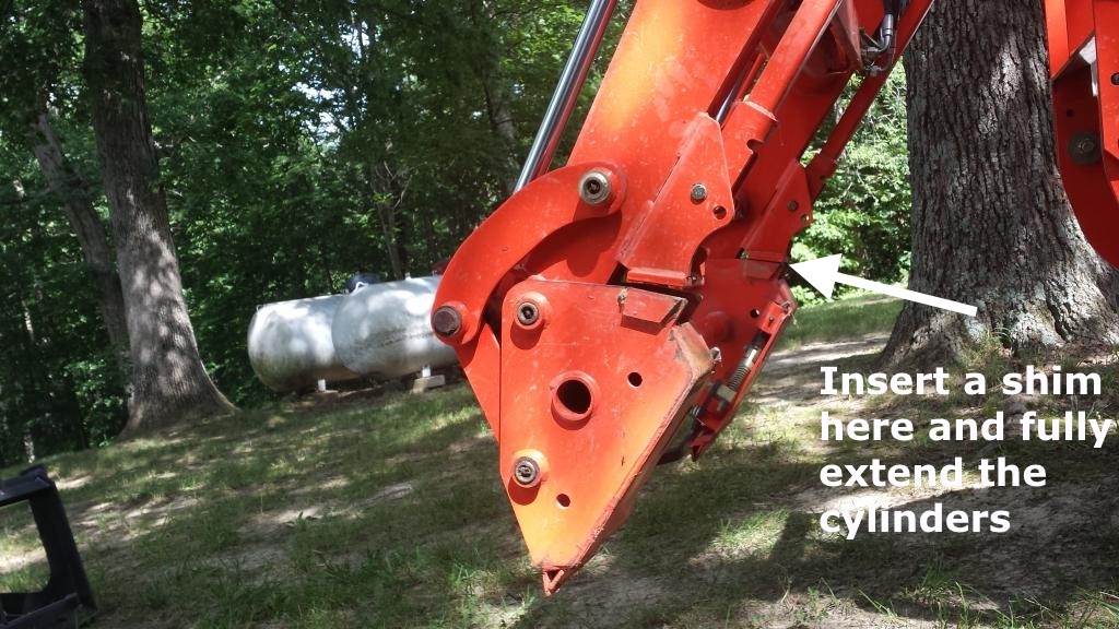

I've done this a couple of times. Once by using a tree grabber and twisting forward dump on a to big for implement tree and I think my grapple was working and a limb lifted one of my lock down levers and one side came loose. The result is one lift arm was out about an inch past the other one and couldn't get bucket back on. Gary from Barlows told me to put a 2x4 behind one arm and whack the other arm with a big hammer. I've also tried pushing the long one against a tree but the 2x4 behind one arm and curl back did the trick a couple of times. The torsion bar looks bent but the bucket and other front attachments now go on like they did when new. Look like two wrongs makes it work or made mine work. :D:cool2:
   / Tilt hydraulic cylinders out of sync #25

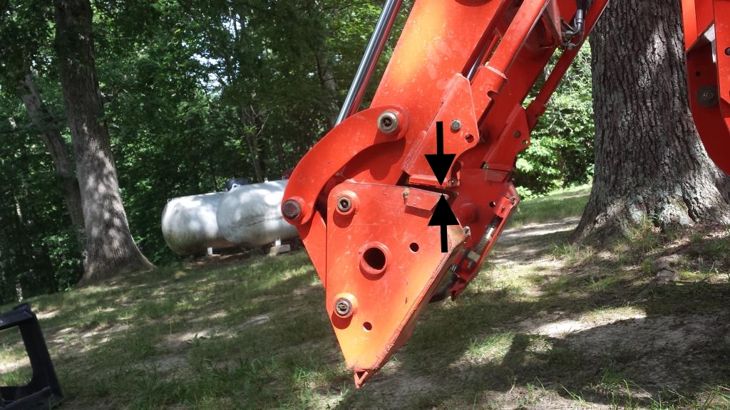

My 3301 did it also way back when I had a latch come off when moving brush.
I did the “push against the tree” method with one arm and it worked well.
It seems to be slightly off though so I’m going to try the shim between stops trick to make it better.
I was planning on cutting the torque tube eventually but it’s been working fine for about 3 years now.
   / Tilt hydraulic cylinders out of sync #26
The ssqa on tractors are pretty wimpy. We mow with the bucket off with B26 to reduce wear and tear and help with maneuverability. Any bump will upset the timing. Had the grapple hydraulic lines sometimes unlatched the left side and bend the tube. Fixed the unlatching by bungee cord the lines to center of the loader torque tube. Only about a 1.25” round tube connecting the sides. Pretty weak. Can easily bend back or when connecting retract, curl back all the way will straighten enough to lock in the lower pins. If I did any cutting or welding to straighten it would be to replace the torque tube. 2” square tubing would be a better torque tube. Even calling it a torque tube is wrong. More of a spacer. It gets torque strength by being connected to an attachment. Guess the engineers didn’t plan for you to operate without some attachment.
