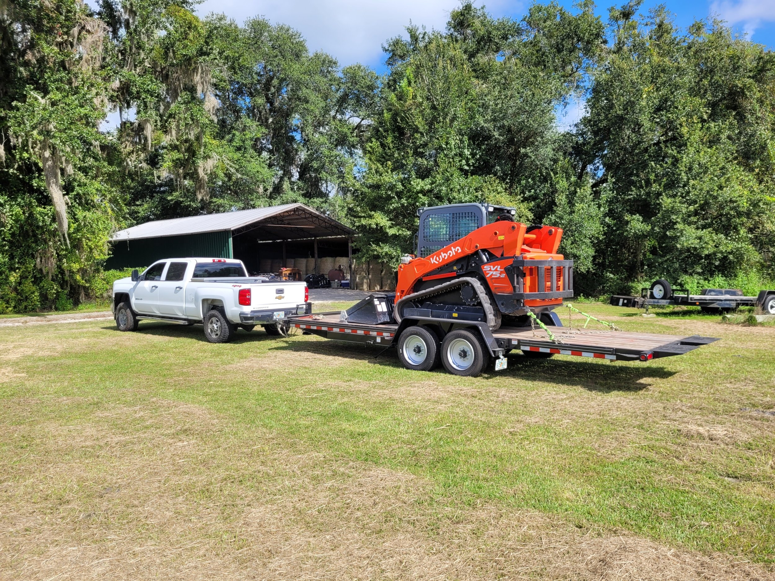

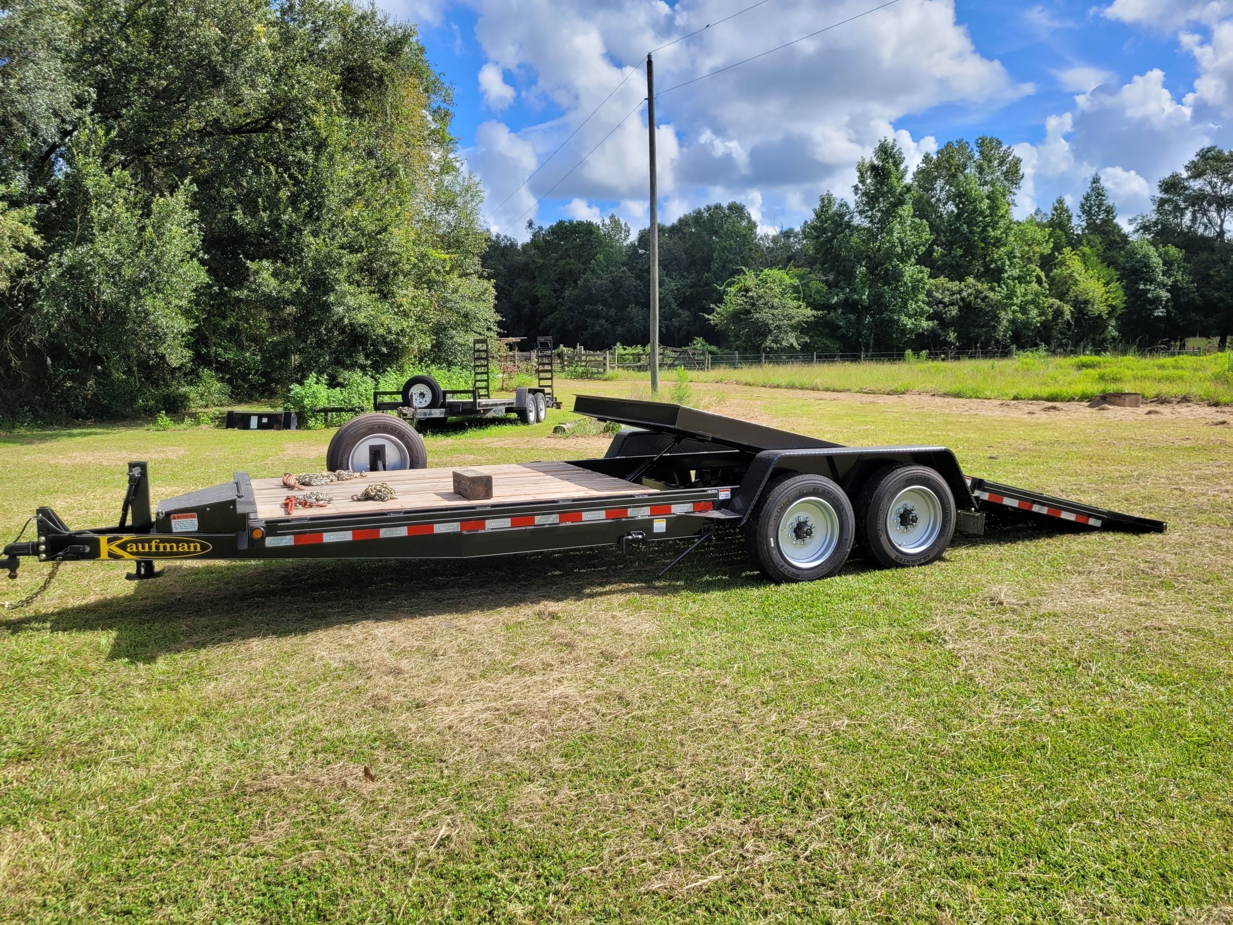

I bought a tilt bed. Really great for loading and unloading the tractor. I regret it because I can't load other stuff on the trailer and put the tractor behind it.
Why not? Bed too short?

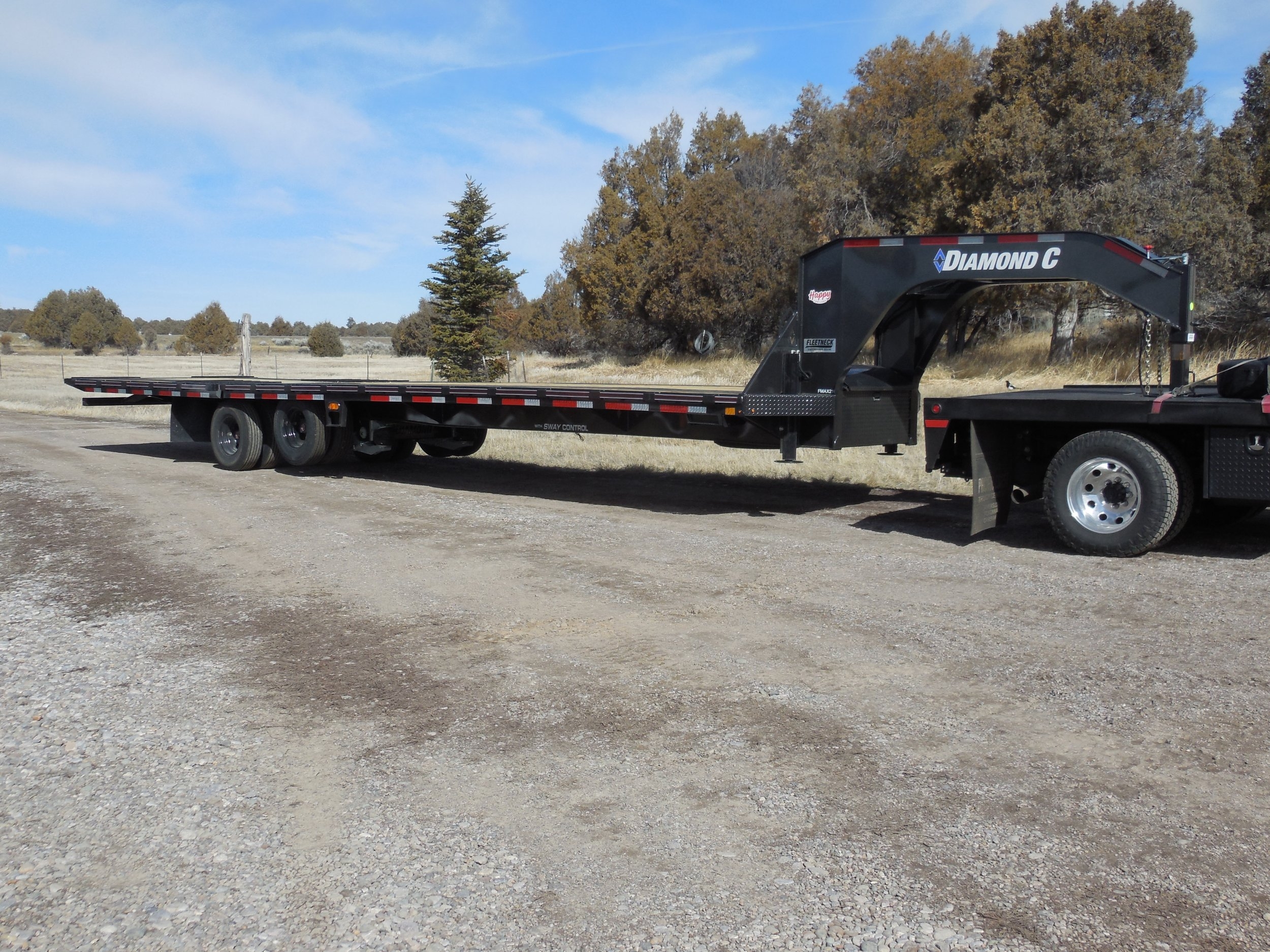

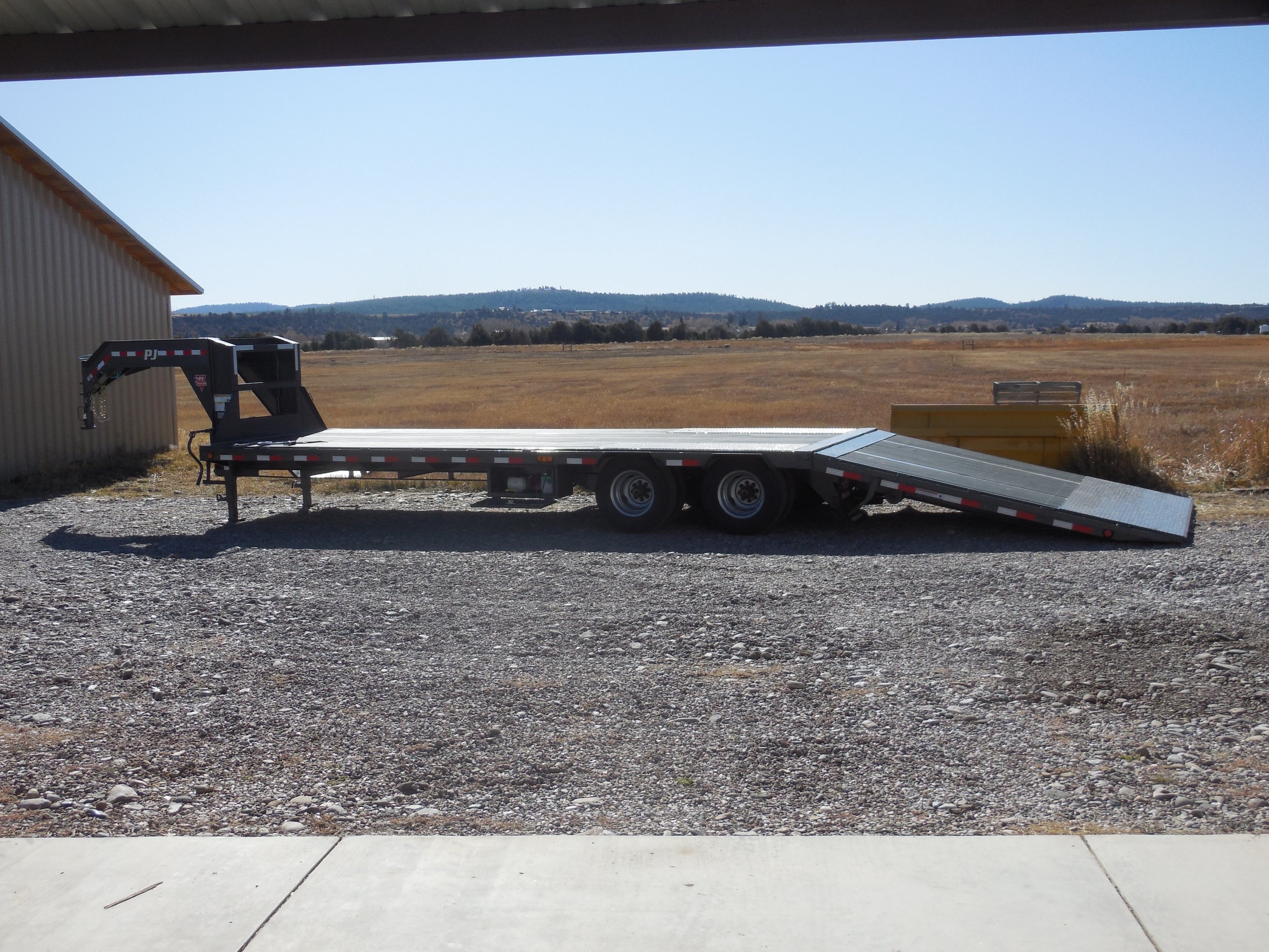

This 32-foot hydraulic dovetail will be for sale in about two months, when the ordered 35' is built.
Overkill for many perhaps, but the air suspension and disc brakes are very nice to have.

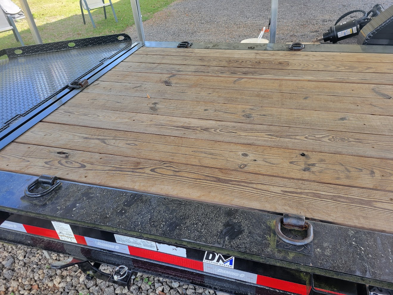

No, because the tie downs are on the frame and not the bed so you can't secure the items before tilting the bed to load the tractor.
That's an easy fix for trailer places, or friends. Just have D rings welded on, I did prior to driving it off the lot, didn't even cost anything extra.

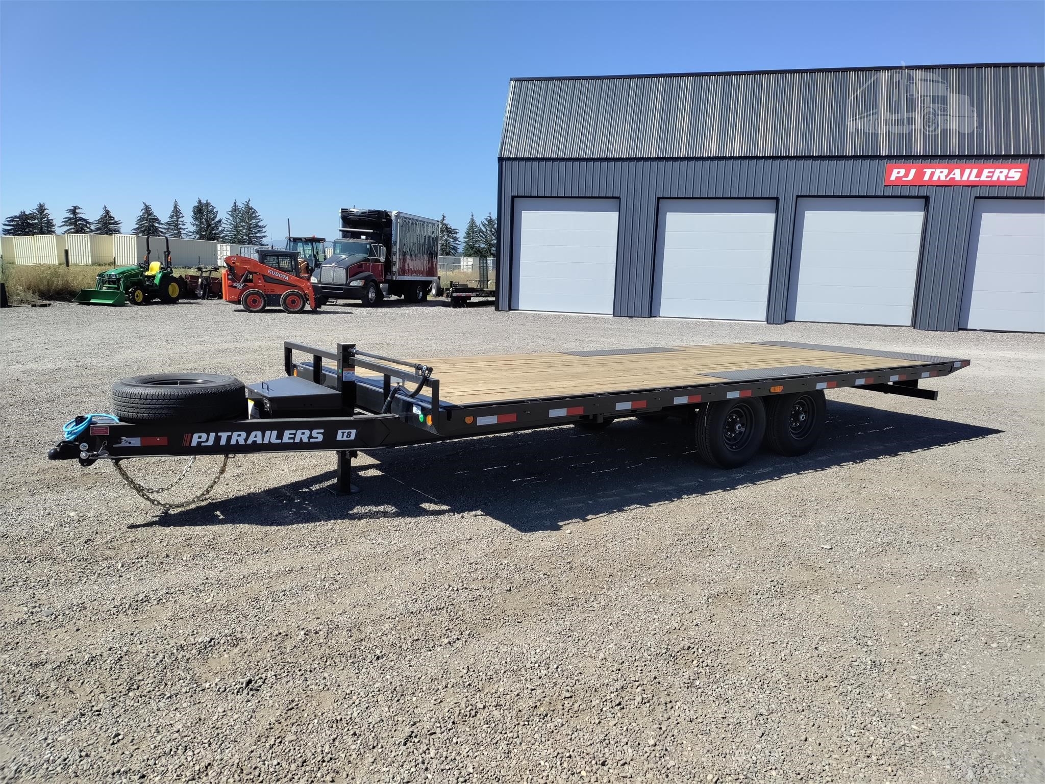

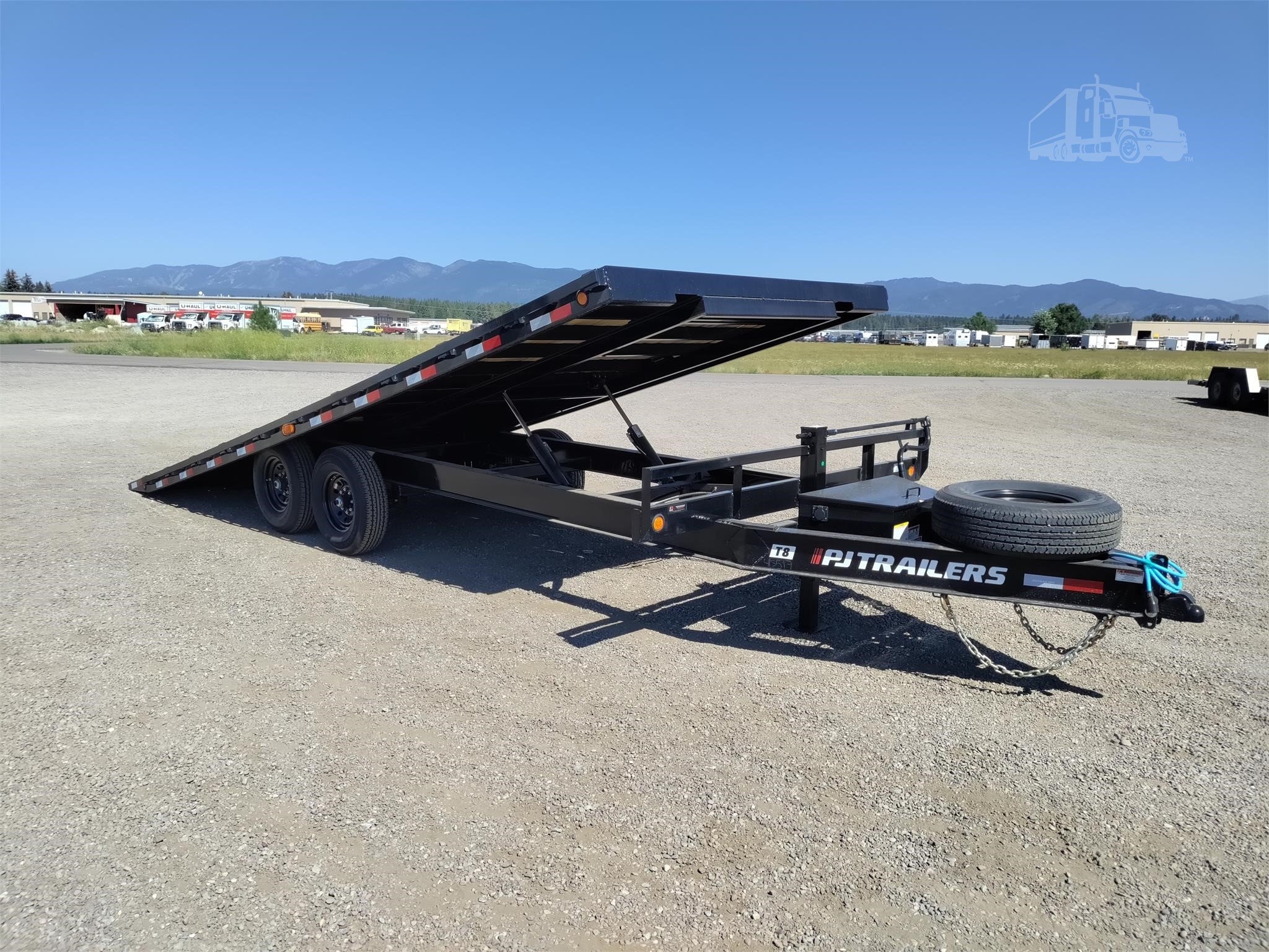

I just sold a MidSota 22ft dovetail trailer last week for $900 more than I paid for it three years ago. I sold it because I replaced it with a PJ T8 deckover hydraulic tilt trailer that works way better for me. I can fit either tractor with the deckover, and much prefer the one-piece deck because I want/need to be able to pull a disc, rotary cutter or folding rotary cutter up onto the deck as well. I like the 8"x4" I-beam construction. I have a PJ Low-Pro 16ft dump and PJ 10ft dump (single axle) so quite like PJ products.

Hydraulic dove tail is the way to go. Ever since I got mine, my other trailer is used as a back up only. Such a back saver, and it applies down pressure so the trailer doesn't want to lift off the ball (mine is bumper pull) while loading.

Not sure why that couldn't work.
I've loaded cars with low breakover angles on my 32' PJ. Drove them up on the tail, then raised it and drove onto the deck.
Of course, if the distance from a tractor's rear axle to the wheels of what's pulled behind it is three or so feet longer than the dovetail it may not work out.
