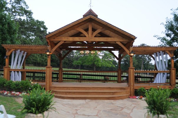

Here are pics of the finished patio area. We have enough room for an 8' isle down the center and roughly 280-300 chairs. I'm uploading pics now from this Saturday. I finished installing the wedding pergola on Friday and had our first wedding in this area Saturday. The bride had planned to setup in the grass for her wedding. She had no idea we were building this area as it wasn't planned when they booked the venue last year so they were pretty pleased to be able to use it. I think we ended up with right at or just over 3,000 sq/ft of paver installation.
Patio10_01
Patio9_01
Patio8_01

This set of pics gets me caught up to where things stand at the moment. I'm hoping to start digging footings this week for stone columns and trenching for electrical. Looks like I may be making a trip to Oklahoma tomorrow to look at some stone veneer for the columns. My source I used on the home build dried up so now I'm in need of something that will tie in well with the patio.
2017-08-21_09-26-59
20170819_155841
20170819_160150
This pic gives a good idea of the scale of the patio. They had 120 chairs setup for Saturday's wedding. Right now we are using the current metal chairs we have for our reception hall. I've got new white folding chairs coming for the remodel.
2017-08-21_09-27-39

Really first class planning and building!!
/ Timber Frame Build - Round 2 #26
VERY IMPRESSIVE!!!! I really like those pavers and how you created a walk way with them.
