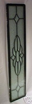

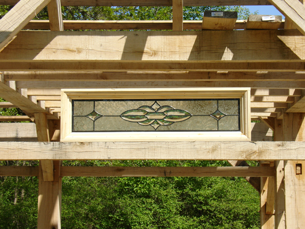

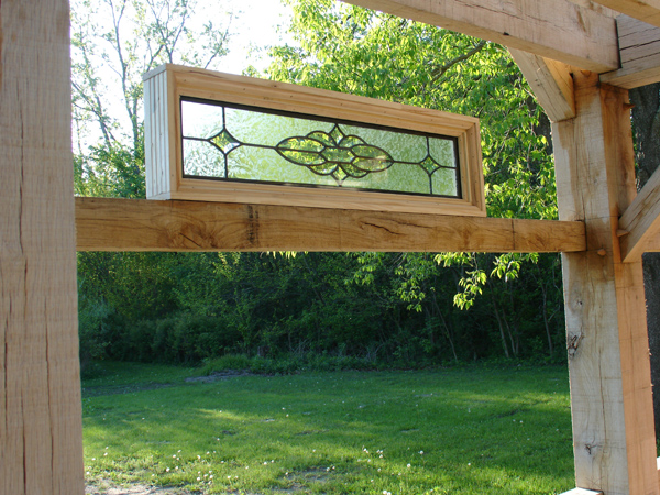

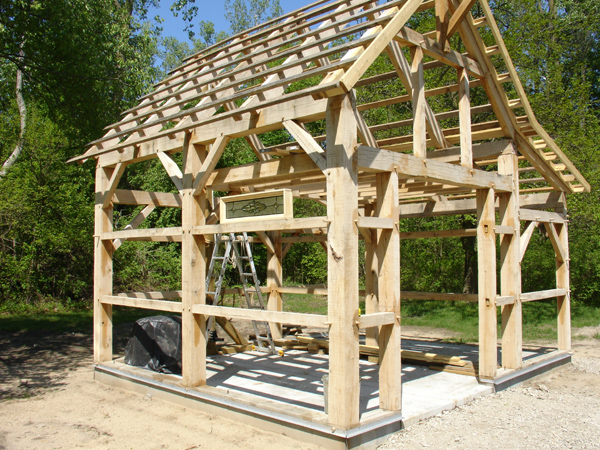

Still making slow progress but getting things done. I got the front gable soffits framed in and the fly rafters on. I don't have enough time this weekend with Mother's Day , etc. to get everything out and since I needed to get the windows framed to be able to cut and install intermediate framing I decided I'd better get them framed out. If you remember I started with leaded glass panels sealed between two layers of safety glass. Some door frame stock and some moldings later I have one of the windows framed.
Over the winter I picked up a few e-bay goodies. I got an 8 x24" redwood tombstone gable vent for the back gable wall peak. I also picked up 3 15" lightning rods probably from the 20's or 30's. The barn will have a working lightning protection systems. Last week I found old copper woven lightning cable. It already has a nice verdigris patina and I think it will look good against the galv. roof. There will be one rod on each end and one in the middle then I'll use white porcelain insulators to support the cable between rods and keep it off the roof. I got 50' for $40 delivered which probably saved me $100++ over new and the verdigris finish was free.
Here are pics of the completed framed window and its placement. First pic. is what I started with, the last three are the finished window.
Regards,
Kevin
