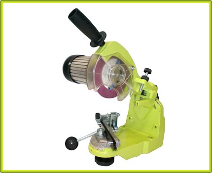

Are the Timber Tuff sharpeners any good?

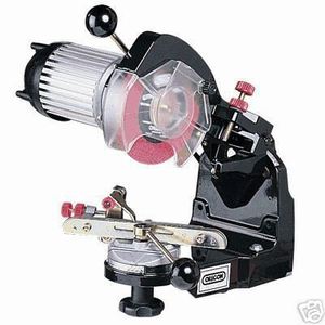

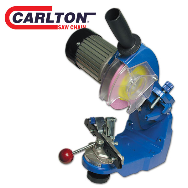

And the Northern Tool http://www.northerntool.com/shop/tools/product_200327449_200327449
It sure looks better than the Harbour Freight all plastic model . Of course its not quite as nice as the top line models, but its currently on sale at Princess Auto for $129 ($60 off) Upright Bench Mount Electric Chainsaw Chain Sharpener | Princess Auto
Worth it?

I am just a homeowner that burns wood and I got one after using a $29 HF one for years. I like the Timber Tuff sharpener very much. It has plenty power, a work light and seems sturdy. I never used an Oregon sharpener, but at $100 +, you can't go wrong. I would buy one again.
/ Timber Tuff chainsaw sharpener, Any good? #3
I can't tell if that is a plastic or metal body painted green. I am guessing it should work just as well as the others. Keep it clean from chainsaw dust and good wheels on it that should work great. I have the German built Maxx which does a pretty good job on all sorts of chains with the different angles.
/ Timber Tuff chainsaw sharpener, Any good? #4
It is a green painted version of the Northern Tool grinder that has been so popular....... essentially a knock-off of the Oregon. I have the Northern Tool version and love it. For sure it would benefit from better quality wheels, but does work well as-is. Once you get beyond a saw or two.... you need your own grinder. My local shop was charging $13 per chain. It didn't take long for the grinder to pay for itself.
/ Timber Tuff chainsaw sharpener, Any good? #5
I have the Harbour Freight sharpener and my friend has the Timbertuff he bought on sale at TSC Stores (for about $100 - cheaper than PA) The TT machine is much better than the HF machine and does a great job- The bigger wheel and metal pieces make for a better, more precise cut. Princess Auto also have a blue plastic machine that is similar to the HF machine in price and size. All of these machines beat the other methods if jigs etc I have tried but if I were making the decision today I would buy the TT machine -- JMHO
