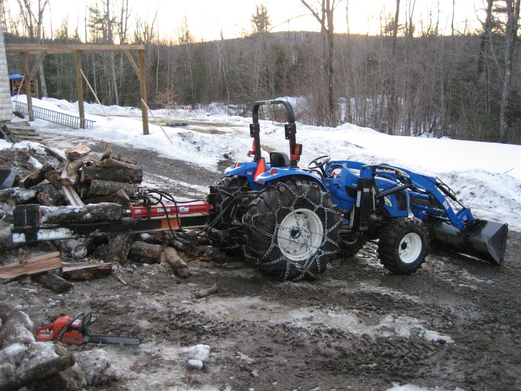

Taking advantage of our brief respite from Winter, I ended up splitting some wood yesterday. Ran the tractor at 1400-1500 RPM.
~Paul
