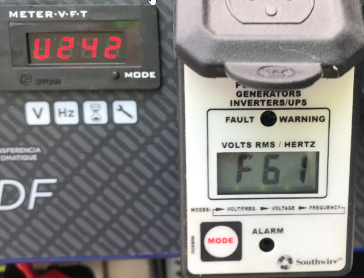

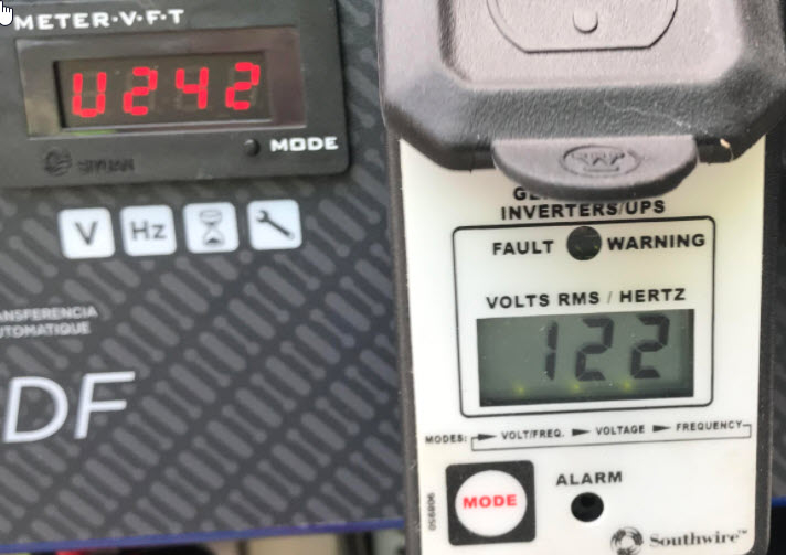

For anyone interested in what a new generator does and what limits are acceptable, I did some digging tonight. Do your own research but this is what I found from a couple of sources that looked reputable. Here is one.
My takeaways were:
-60 Hertz +/-3 Hertz and 120v +/- 10% are limits for sensitive devices.
- Generators are set at the factory to run at 60-62 at no load so it will drop to about 60 under 50% load.
I got my Westinghouse 12500 today and started it up using propane and then plugged in my meter under no load. Hope this helps.
