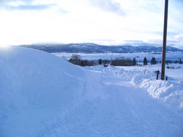

I wrote to you in your blog regarding the utilization of a tractor (versus a lawn mower) and also recommended this site.
I live north (closer to the 45th parallel) and west (of the mountains to your west) of you.
Not sure of your snow conditions, but these photos are typical of ours.
A tractor (not talking about a lawn mower genre as sold at bigbox.org)
will give much more utility year round, and you will find more capability for your intended use.
