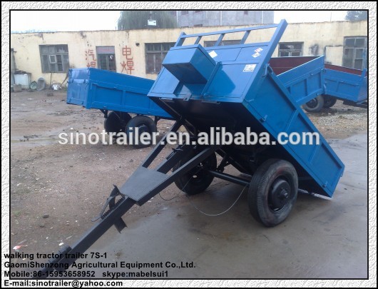

The trailer pictured look's to work well but limited to light loads. It might be improved by shortening frame at rear,moving pivot foward on box so box hit's the ground at full tilt. That would require saloon doors in place of drop down in picture. Which brings us to dumping without leaving driver's seat. How will you control any type door without getting off tractor? Early on (1960s)when round hay bales were catching on,there were lots of single bale buggies used behind trucks that used a rope to lock and unlock shoes against buggie tires. Rope was generally tied to driver's mirror and operated without getting out of truck. When wheels were locked and backing up,platform dropped to ground. If driver released tension on rope,the buggie would scoot along on ground to slide forks beneath bale. If tension was maintained,buggie would rise in front then roll over effectively dumping bale. When wheels were locked pulling forward,platform raised off ground and moved foward into trasnsport position. They were very popular but then replaced by the spears you see today mounted on rear bumper. One of those would only require fabercating a box on it. In the event you aren't familiar,round bales weigh between 600 and 1100 Lbs,depending on type grass and how tight one chose's to make bales.

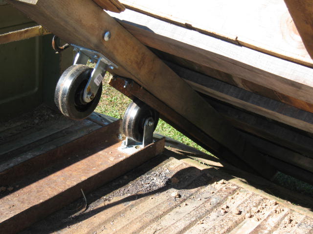

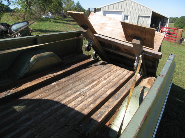

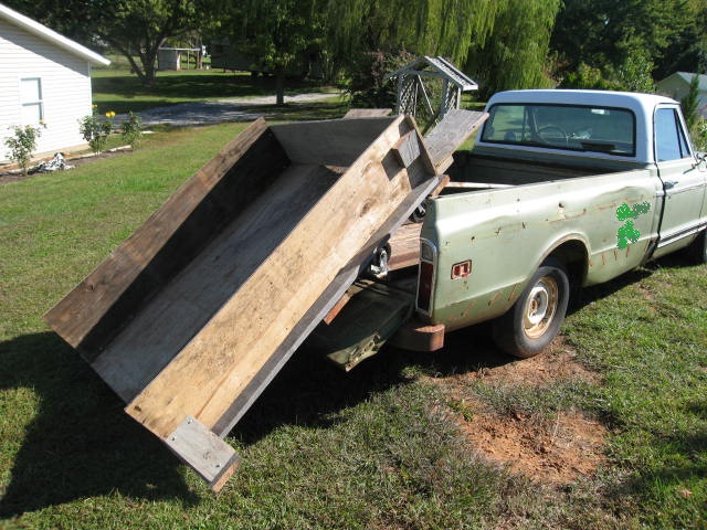

Personally, I would vote for the 12v battery/electric winch/mast method- but here is another idea:
I built a rolling box in the back of an old pickup truck- perhaps you could do something similar on a bare trailer frame.. The frame needs to be pretty high for it to work- and you can't dump up a hill.
There are two pieces of channel iron bolted to the pickup bed that act as tracks for the front rollers and one piece of channel iron bolted to the passenger side beam that acts as a guide for the rear of the dump bed.
That old beat up truck is a 69 chevy. The proceedure to dump is as follows.
1. Drop the tailgate while on a level surface ahead of where you want to dump.
2. Shift into reverse and approach the spot where you want to dump the load.
3. Apply the brake firmly so that the bed has just enough momentum to roll out of the truck bed and then the back drops over center. The 2 straps catch the whole bed from rolling out onto the ground. I would guess that too quick of a stop would cause the straps to beak and the whole apparatus would come out of the truck.
4. To reset it- lift the back of the wooden bed (not too difficult- maybe 60 lbs) and roll it back into the truck. Then latch the tailgate and load it with dirt.
[/ATTACH] dumpedside.JPGcloseup guide wheel.JPGdumped front.JPG

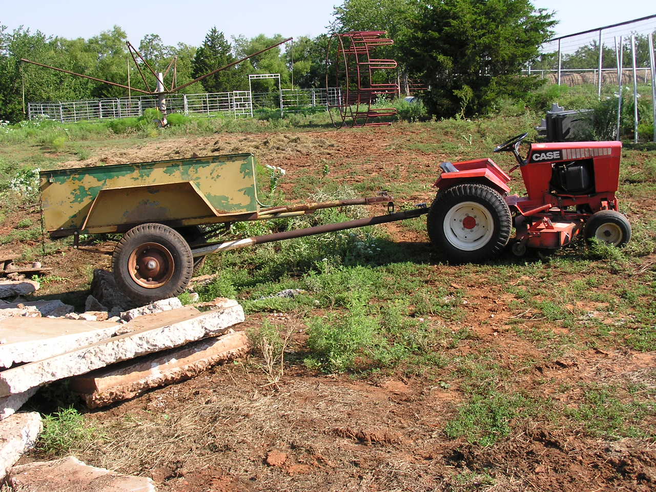

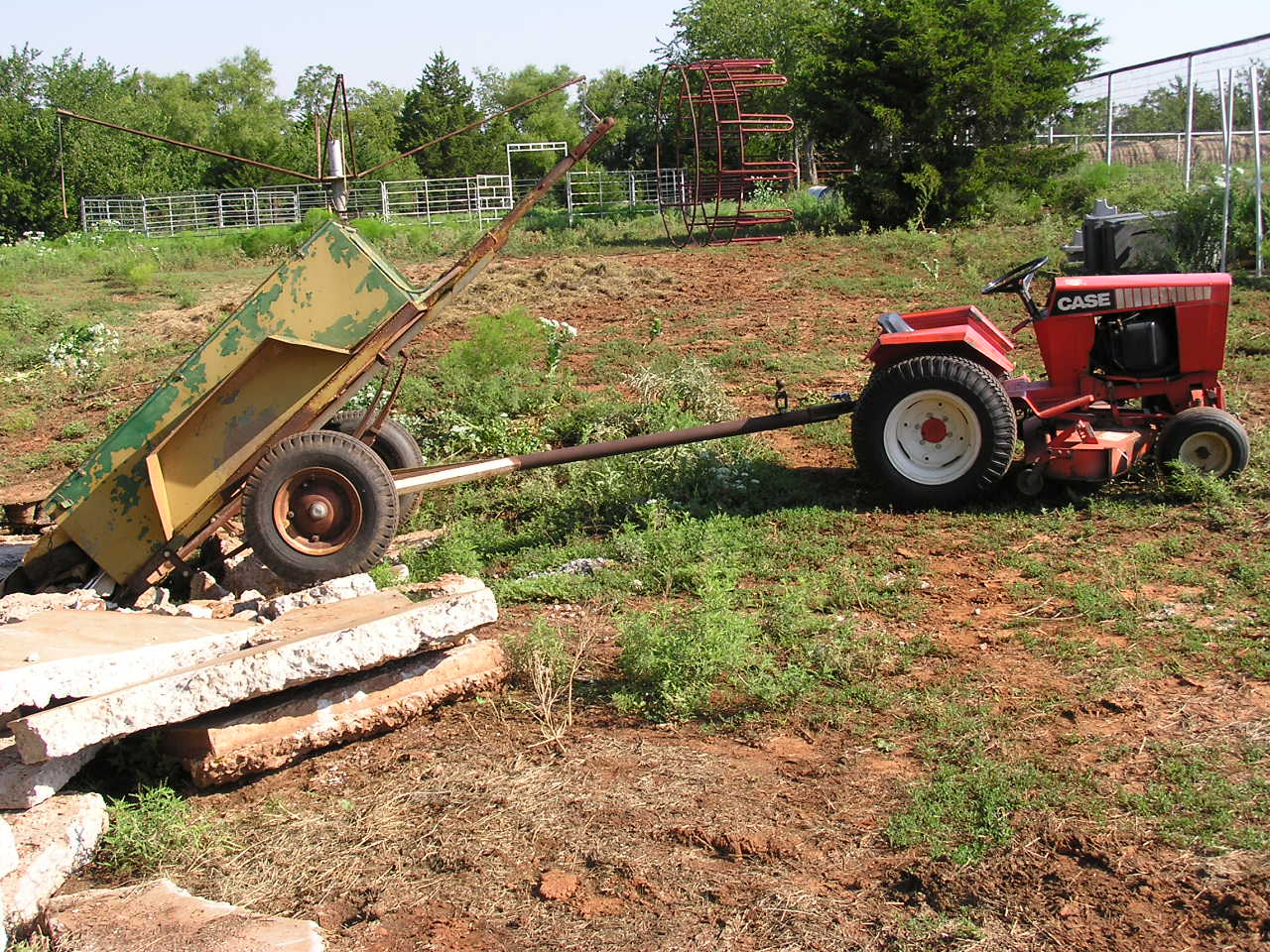

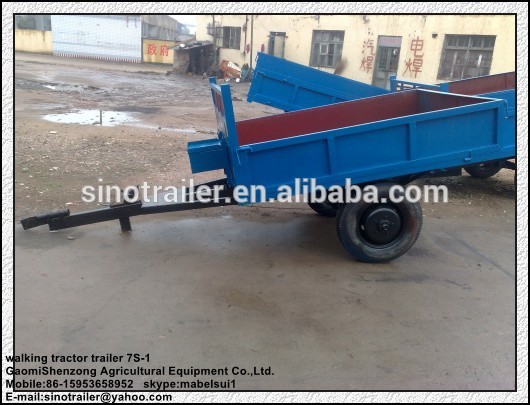

The first picture I posted is a dump trailer made for a two wheel walk behind tracter: Walking Self Tipping Dump Tractor Trailer Tractor Dump Trailers - Buy Walking Self Tipping Dump Tractor Trailer,Tipping Trailer,Two Wheel Trailer Product on Alibaba.com
I had thought about the 'digging' the rear of the trailer into the ground for tipping but you not really going to tip all your load.

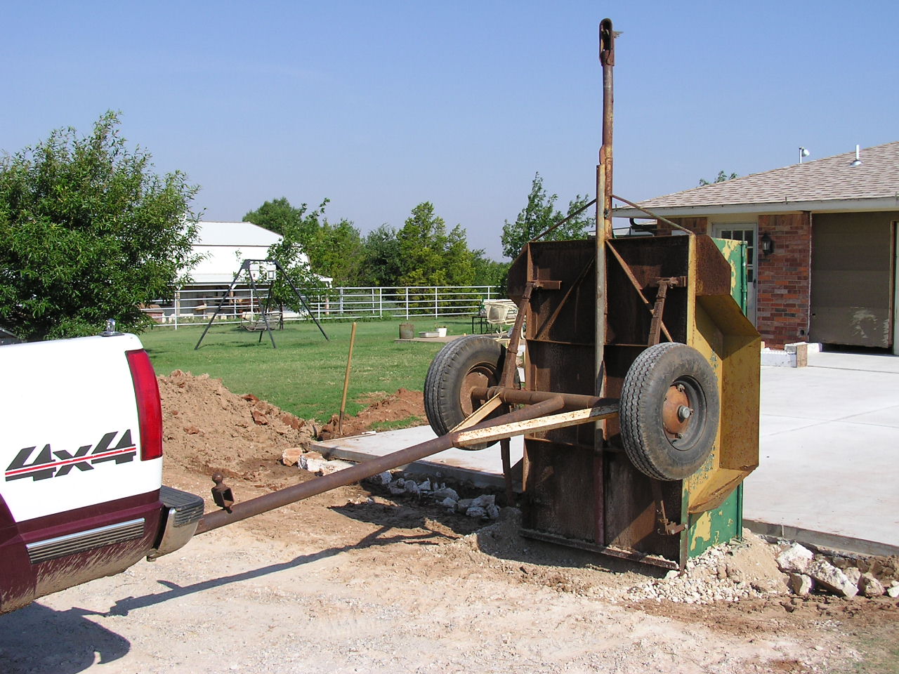

I made this trailer into a dumper about 15 years ago, removed the drop axle, cut a mobile home axle and slipped three pieces of tubing over it, welded a longer tongue and angle braces to the tubing, put a pivoting ball on the new tongue for the original coupler to latch onto.
To dump, unlatch the original coupler:
If needed, back up. :thumbsup::
I have had it completely upside down when hooked to the front hitch on the tractor I had then.
