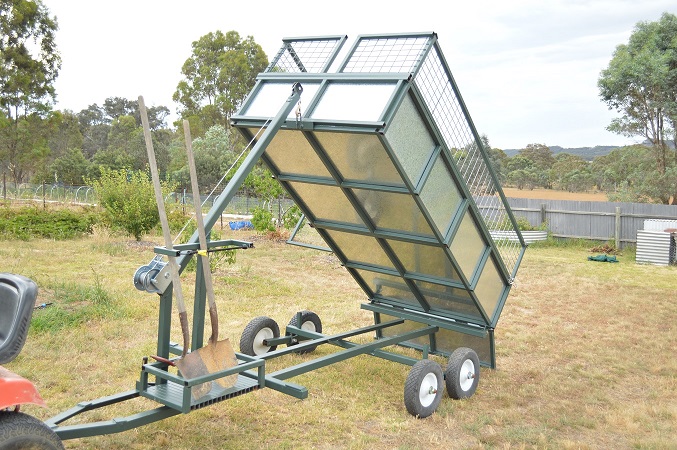

I would like a tipping trailer to go behind the tractor. Ideally I like to be able to fill it, tow it and dump with leaving the seat, I don't know if this is possible.
I could build something similar to the one I built for someone else just not as big (see pic). I would put a remote control winch in stead of a manual one.
I could also just build a solid trailer and tip it with the fel, I don't think that would be the most efficient though.
I don't have remotes so I can't hydraulicly tip anything, and I would be forever disconnecting and reconnecting them.
What would everybody else do in this situation?

If money was no problem I'd use a commercial built dump trailer with 12 volt hydraulic pump. If money is more of a problem I'd settle for a similar design as pictured but with an electric winch. The other and cheapest options would be as pictured or a regular trailer you dump with the FEL.

General thoughts on designs that I see;
Most trailers I see that self dump are balanced and sit high off the ground. The axle being centered under the load with the pivot point in the same centered position means that at least half the load will be helping the trailer dump. On the trailer design below, the load is no help, pretty much the whole load has to be lifted to dump.
527543d1509939369-tipping-trailer-suggestions-dsc_0265-jpg
The balanced trailers sit high, so the tail hanging out the rear beyond the axle will dump completely before hitting the ground. Shorter trailer means lower to the ground.
I have a trailer at work that tilts more than it dumps. It also has a centered balanced axle position. It's very easy to move around by hand. It tilts more than dumping because it's so low to the ground, so the tail hits the ground before the angle can get high enough for dumping material. So it's good for loading rolling stock, not dumping material.

For ease and $$$ a 12v winch on a mast like the other one I built maybe be the best.
