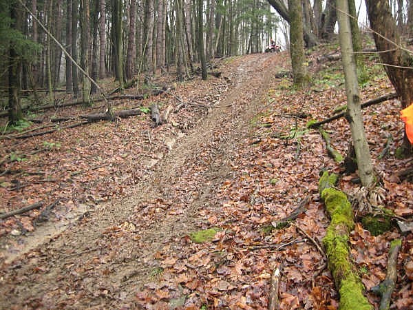

I am a newby to tractors, but I quickly realized common sense is not working well. I live in a relatively rural area of central VA (lots of hills). I was amazed to find out that 10 people have died in my county during the last 16 years, or was it 16 people during the last 10 years. Whatever, they were all very experienced farmers driving old tractors (no ROPS, seatbelt). Since there are not many people where I live that type of statistic makes me conclude that common sense is not sufficient.
