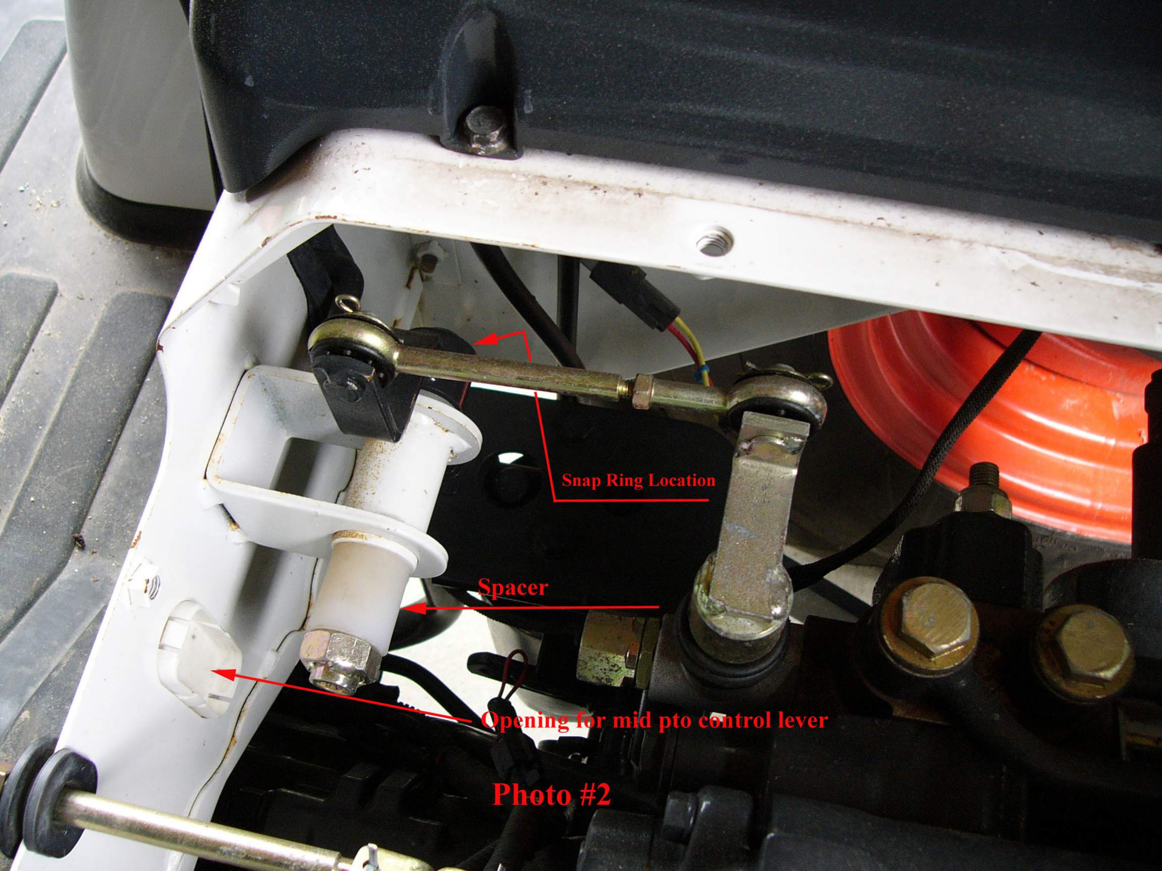

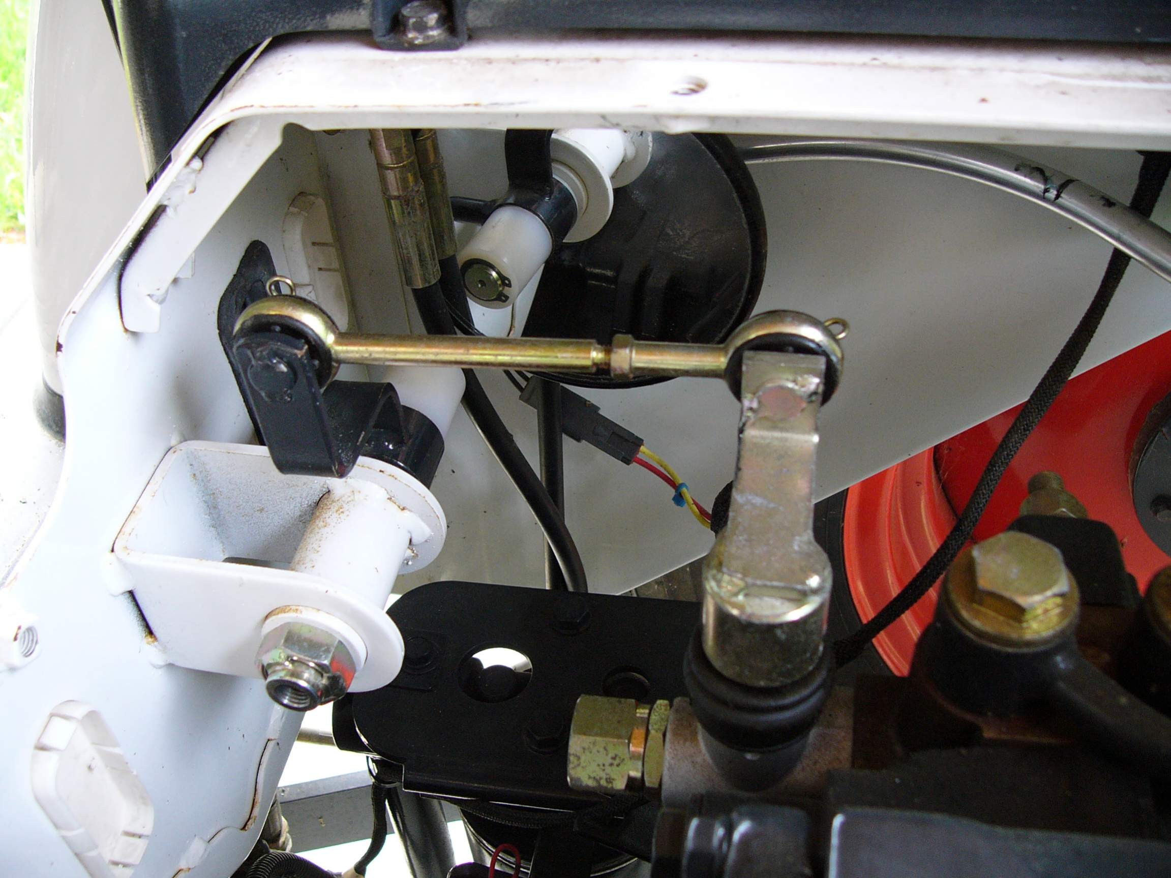

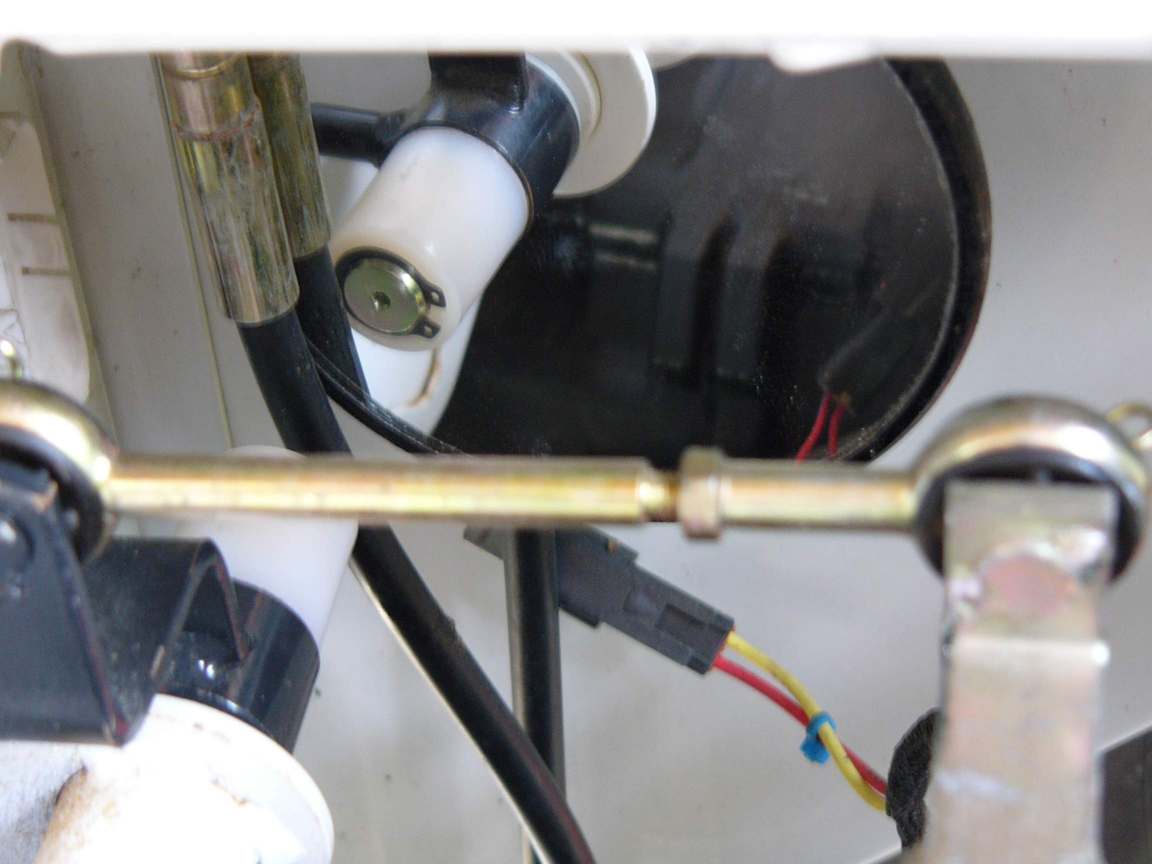

I'm in the process of installing the control linkeages for engaging
and disengaging the mid pto, which involves moving the spacer
shown in photo #2 from it's present location to the end where the
snap ring is. Apparently, when the dealer installed the single
rear hydraulic auxilliary kit, they opted to install the spacer
in it's present location, instead of where Bobcat intended it to
go. The Bobcat rear auxilliary kits (single or double) utilize the
same shaft, adding the spacer when only the single auxilliary
kit is installed. If the spacer had been installed just behind the
snap ring, as depicted in the Bobcat instructions, I wouldn't have
to remove the shaft at all. Photo #1 shows the area where the
rear auxilliary control is. Photo #2 shows the spacer and the location
of the snap ring that must be removed to relocate the spacer.

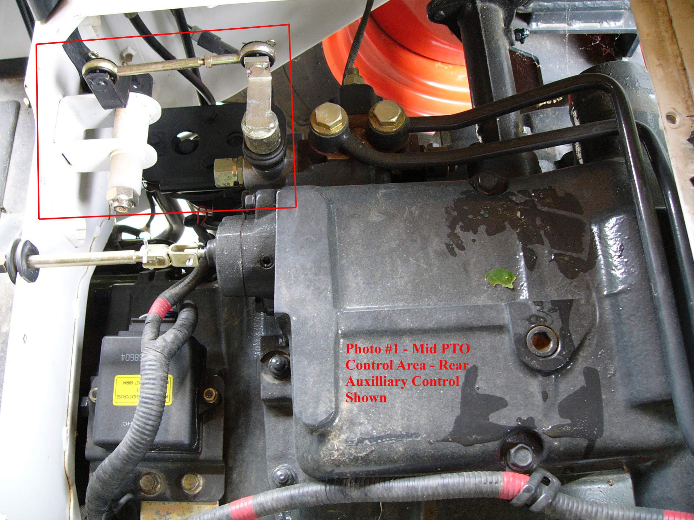

The head of the shaft has to be against the bracket to make room
for the shaft extension for the mid pto control lever. Photo #3

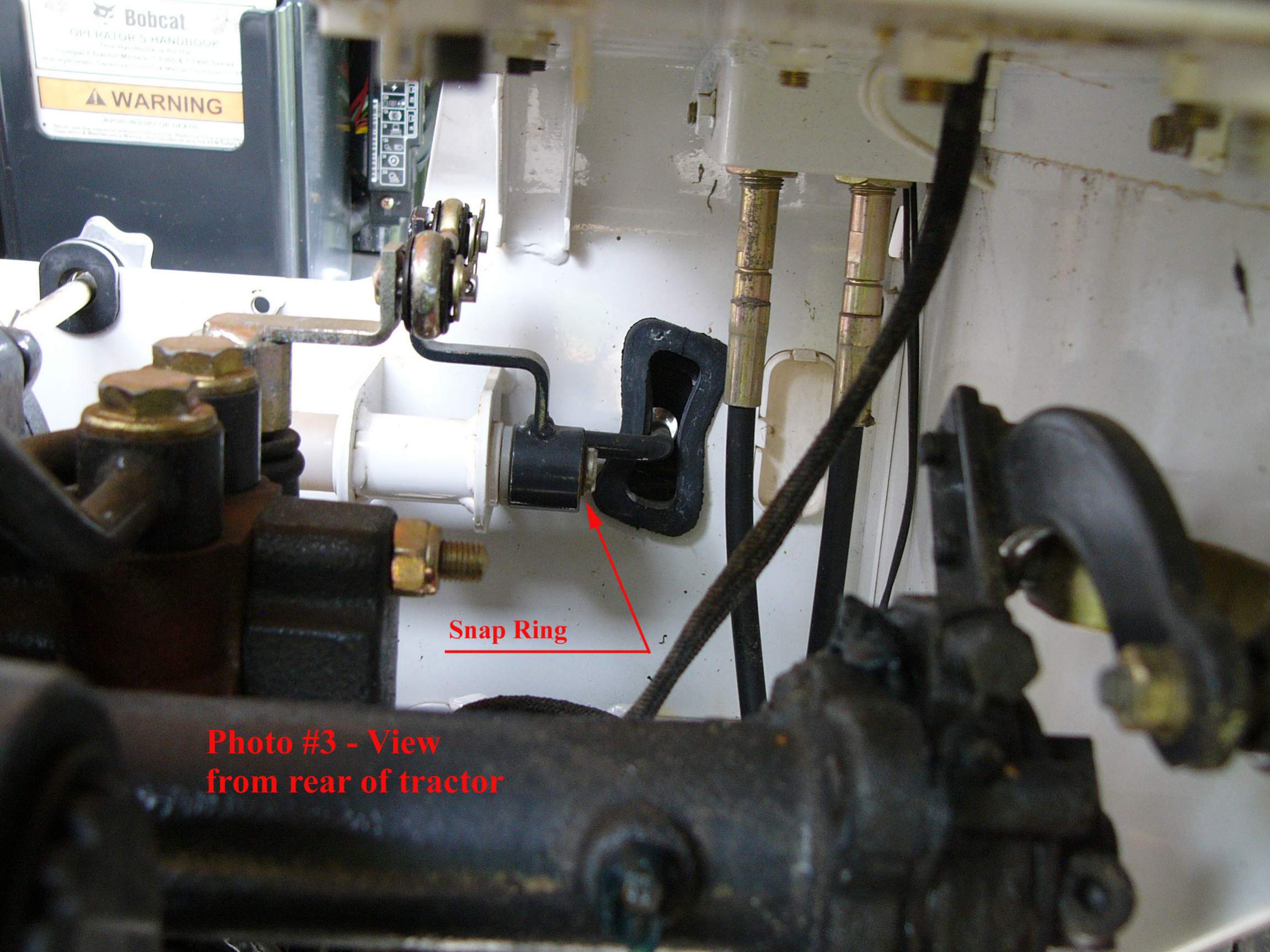

shows the snap ring as viewed from the rear of the tractor (more
than an arm's length away).
I haven't been able to get a grip on the snap ring using the
snap ring pliers, since I can't see the hole locations of the
pin holes in the snap ring. I even tried using a mirror but
my hand-eye coordination just wasn't good enough to make
that work. By the way, the tractor is a Bobcat CT335 HST.:banghead::banghead:
Any tips or suggestions on how to approach this problem?
The only access I seem to have is from the top as shown
in Photo #1. The retaining ring pliers have the 90 degree
.047 dia. pins.

Is that a "nut" that can unscrew?
Couple ideas requiring destruction of replaceable parts
1) Pry up the ring then with pliers tear it off, replace with a new one.
2) Cut/grind the plastic spacer off then you may have better access to snap ring.

So the wide gray spacer in photo #2 is supposed to be to the right of the black linkage in photo #3? And that nut should be up against the white mounting bracket? And then you can put your mid PTO linkage into that hole in the nut on the end of the shaft? Makes you wonder how they ever expected to service that? Probably something simple. Have you asked the dealer how to get the snap ring out?
Can you get a mirror in there and get one pin of the pliers into it? You may be able to rotate the ring around to where you can mark the location of one of the pin holes, then guestimate the location of the other to get the 2nd pin from your pliers in there. I'd remove that gold linkage for better access, too, maybe. Good luck. :thumbsup:

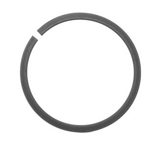

Are you positive it's a snap ring like this
and not like this?
If it's the latter you have to use a flat faced snap ring pliers like this
Even if it is the two hole type of snap ring it might be possible to use a flat faced snap ring pliers to open it up if you can't get the tips on a regular snap ring pliers into the holes

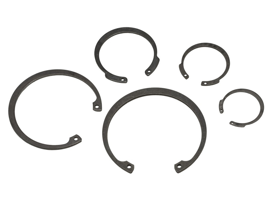

Yeah, I was thinking inside snap ring. :mur: Like this... probably not on a shaft.

Put a wrench on the nut to keep the shaft from spinning. Use an o ring pic to dig out one leg of the clip. Once started slip a flat head screw driver under the clip and walk it out.

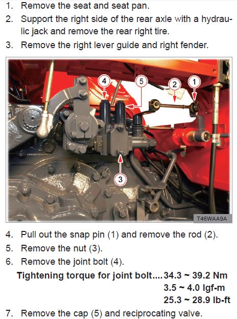

Here is the procedure, and if you look carefully you can see the outside conventional snap ring. They suggest you remove the right rear tire and the fender to get to it. Here is the picture and the procedure.
/ Tips on removing visually inaccessable external snap ring #10
Looks like you can take the wheel off and unbolt the fender for easier access?
and not like this?
I can see it better in the workshop manual and it is the convention outside 2 hole snap ring.

No - that's actually the head of the shaft, with a threaded hole to accept a shaft extension.
The plastic spacer has to be relocated just behind the snap ring, and I don't have a spare,
so destroying the existing spacer is not an option.
"So the wide gray spacer in photo #2 is supposed to be to the right of the black linkage in photo #3? And that nut should be up against the white mounting bracket? And then you can put your mid PTO linkage into that hole in the nut on the end of the shaft? Makes you wonder how they ever expected to service that? Probably something simple. Have you asked the dealer how to get the snap ring out?
Can you get a mirror in there and get one pin of the pliers into it?"
Probably with great difficulty. That's probably why the spacer is where it is, instead of where it should have been!

Success!!!:thumbsup: Thanks for all the suggestions, and to MossRoad for his suggestion on the mirror
and removing the gold linkeage temporarily for better accesss! I had tried the mirror before but was
holding the mirror with one hand while trying to manipulate the pliers with the other. No Go, but I
managed to locate the mirror where it would set unattended, allowing me to use my steadiest hand
for the pliers, and I did also remove the gold linkeage for better access.
TBNers come through again. Thanks.
