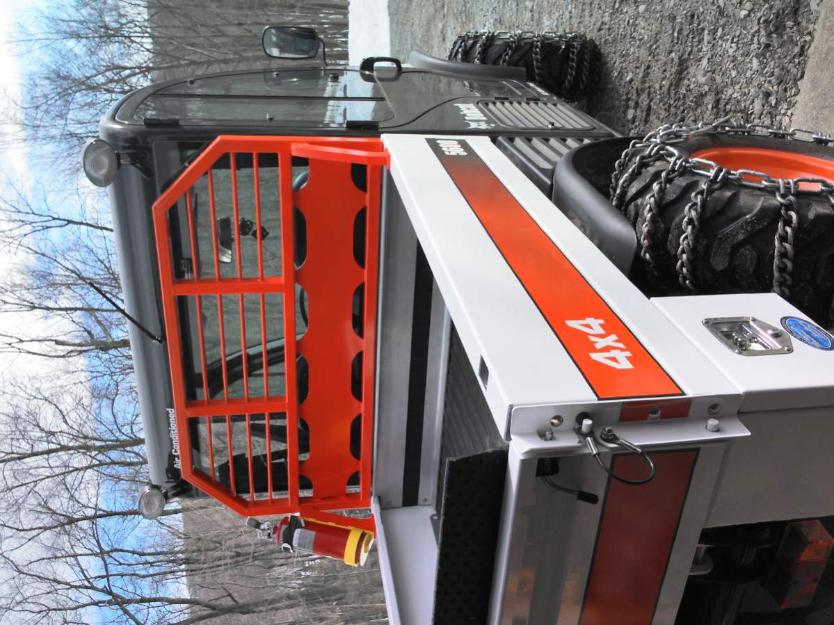

I countersunk rims on back side to push wheels out for chain clearance. Clearance between tire and spring on inside is not enough for heavy duty chains. Chain diameter is 3/8... Rims are plenty thick to achieve this.

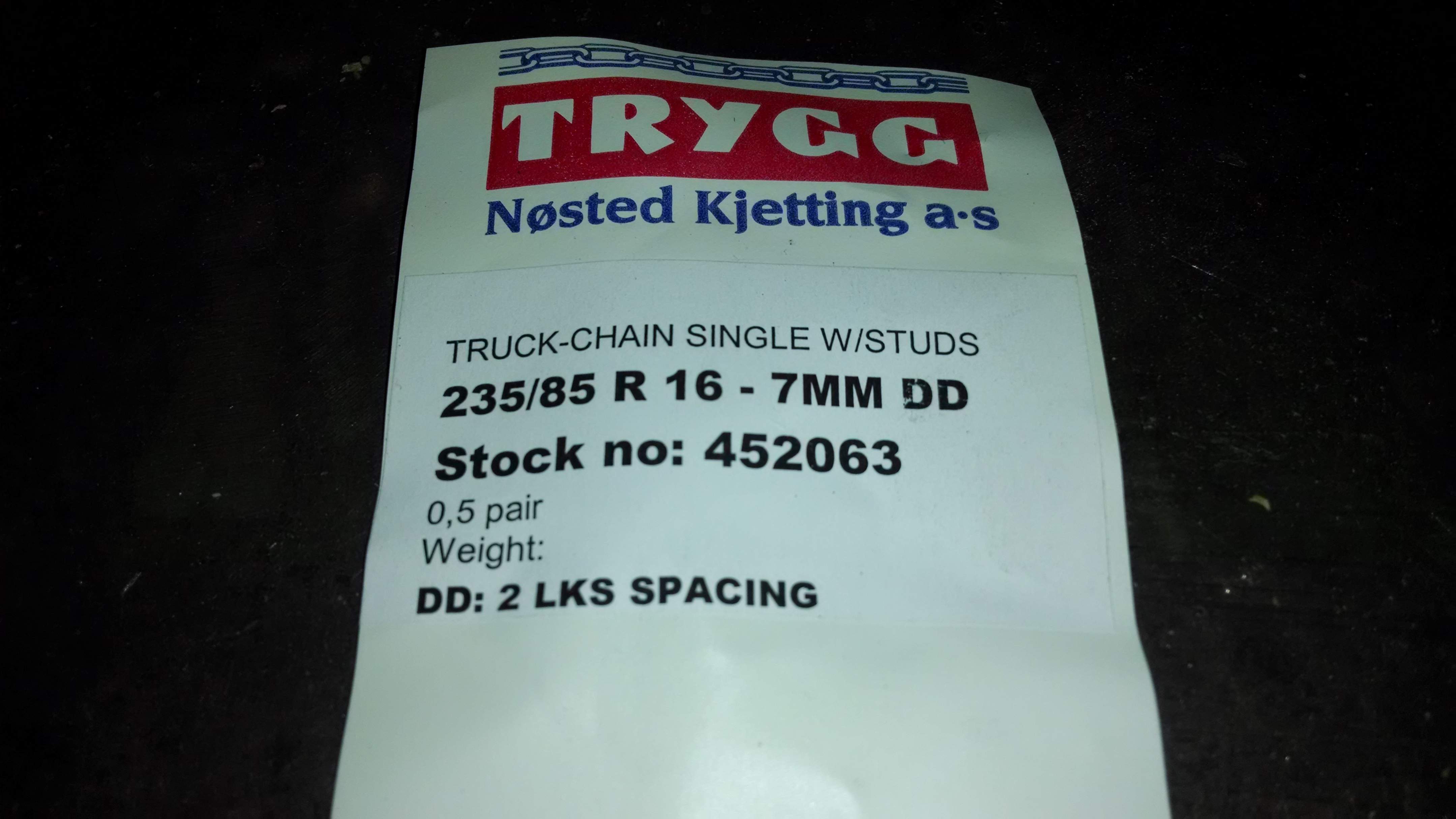

I will need to check when I get home for the actual chain 'model'. They are a 'ladder' style and not web styled. Not knowing how long the new chains would hold up, I did at the time purchase another six axle sets which are still brand new in the bags in my shop. let me confirm and get back to you. You may also wish to look closely at the clearances on your unit as things do changes with newer models. FWIW, in the future you will find pricing, shipping, and availability much more desirable if you order in the spring for a fall delivery.
/ Tire chains for 5600 #9
Slummer, et al:
I just read my post and need to apologize, I have been up since 2:00/am my time on 'snow watch' and obviously need to reread my postings before the enter key. Slummer, you asked a question previously that I failed to answer. You asked about chaining all four wheels. The answer is yes, and I almost want to tell that my Service Manager at Bobcat (I have an awesome dealership in Stockton, CA) telling me NOT to chain one axle only. This is not gospel but I would error on the side of caution. I'm attaching a photo (cell phone) of the actual 'tag' on my Trygg Chains. Hope this helps. These chains sure made my life (and back) much easier!
Stihl Man, where did you get the underbed box for the 5600? I like the headache rack, did you make that?
/ Tire chains for 5600 #11
The cab protector I made.. Thax The boxes I did not make. I had them custom made. No one had the size I wanted. The quality of the box I would give them a 9 out of 10. If they would have spent about 1 minute of time with a portable belt sander they would have been perfect. I am EXTREMELY fussy though..
