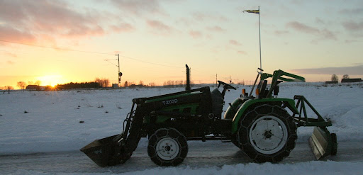

Hi again.
As promised, here's the finished job. Fronts and rears made using the same techniques but in different patterns.
One of the re-occurring comments here is "I did it once, I wouldn't do it again". You'll find me on the exact opposite side to that thought: I've had immense fun at a fraction of the cost of commercially available chains, and these things fit well and function flawlessly. The difference in grip is astonishing - more of a difference than I had expected :thumbsup:
When you do something like this, you learn techniques, processes and a working method. If I were to do this again it would take a fraction of the time and I'd probably enjoy it even more the second time round.
Total cost of making these chains (Including my own time which is free if I'm having fun) is in the region of $200... though chain may well be cheaper in the USA.
All photos can be found here. Picasa Web Albums - Nick - Tractor Chains and as said before, if you want to mooch about in my other albums, be my guest.
Cheers!
/Nick

Hi again.
Cheers!
/Nick

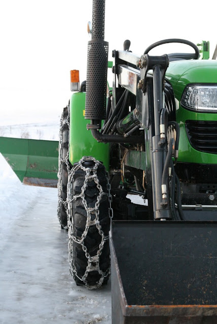

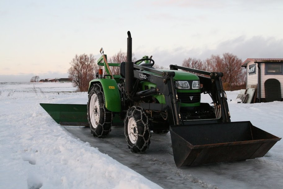

Awww.. you're too kind. Thanks.
Things I've learned so far... If you look at my front and rear chains you'll notice that the "continuous lengths" that run all around the tread of the tyre are closer to the middle of the front tyres than they are on the rears. This was because I'd used the rears before I finished the fronts, and had already worked out that having these lengths slip off the side of the tread was a bad plan: it takes the tension out of the entire system.
The addition of a spring-loaded tensioner is a REALLY useful upgrade, and means that any slack will be taken up... stopping eventual creep and looseness. (Is looseness even a word?)
When this season is over, I'll be shortening the "bars" across the tread on the rears: This'll make them more stable on the tread, and mean I have to adjust them less.
I've had to re-adjust the rears once... and it was annoying. The fronts however have stayed exactly where I put them.
Usage:
With grip comes responsibility Before the chains my "not overloading the drivetrain" safety-net was the fact that I'd loose traction easily. Now I don't loose traction, I loose power.... and I think that this might well lead to me overloading the FEL ot drivetrain at some point if I'm not cautious.
Currently I park the tractor in my warm garage... I line up my entry accurately and ensure that I don't need to steer either way: I suspect the floor will thank me later.
Things I consider to be the most important bits..
The "inboard loops" should be continuous, and not "tensioned" by an extra system as this allows movement... and you don't want that.
The loops over the tread shouldn't go too far out towards the edges of the tread... because when they slip off you'll waste time levering them back on...
The "outboard loops" should be tensioned with an across-the-hub system (huge mechanical advantage) and a spring that keeps the tensioning system tight - even when the chains wear. Check these springs regularly to ensure that they're still tight, because early on in the life of your home-made chains they'll be bedding in a lot and shifting.
Oneday I'm sure I'll be making another set of these. :thumbsup:
