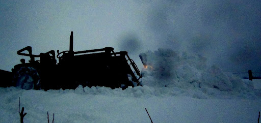

Well.. just got in from clearing 18" of wettish snow.. and I NEVER expected the grip to be so good!! :thumbsup:
I have yet to do the front chains, but they're seriously needed to get steering authority when pushing *that* much snow :D
The cruddy galvanising on the chain has predictably worn in the ends of the links, and the 1% elongation of the chain caused them so seat incorrectly... I kinda expected that, but I'll be finding myself some springs tomorrow to build in a semi-permanent tension on the outsides of them to keep them in check :)
I'll post another update with more pictures when I finish the fronts and install the tensioning system.
If you've never used chains in the snow before, and are thinking "Hmm.. I wonder if they're *really* going to make a difference"
, YES... yes they are. a huge one. Massive. Really really big. :licking:
EDIT: have a Photo. Rear chains only on a Foton 254 4WD... and this pile of snow was moving along happily. A pile a 1/3rd of the size would have had the tyres slipping without the chains :)
