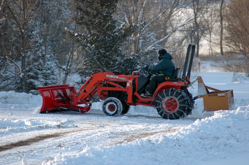

Since 2009 I've used two-link chains from tirechains.com on the rear wheels of my Kubota B2400. Noticeable improvement in traction. But still needed 4 wheel drive in some instances. Also the front end would slide during snow plowing with my FEL mounted 7 foot plow heavily angled and during turns. This year I added v-bar chains for the front hoping to reduce the front end slip. Haven't had the opportunity to test them yet.
BTW putting the chains on my B2400 is not a big deal once you've done it a couple of times. That said I wouldn't wait until it snow to put them on because it does take some time. The chains are heavy so it might be a problem if you have a bigger tractor with larger wheels.
Take a look with chains on rear.
