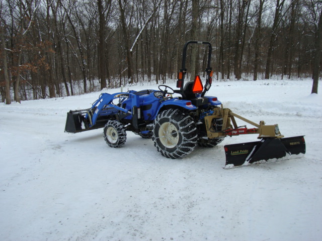

I run 4 link ladder bar chains front and rear on my R-4's.
They work great. The 4 link ladders give me all the traction I need.

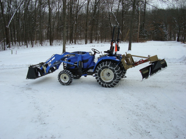

   / Tire Chains on industrial tires? #34
Set up like that on all fours with the 2 link spacing, you don't need v's. Unless you were logging in the woods or something.
What's on the back of your tractor, A heavy duty blade? at first I thought maybe a log splitter. looks like it would have very little upward travel, or is that just an illusion?
JB
JB,
That's a Landpride RB3572 rear blade. It raises pleanty high for my use...about 14" off the ground at the lowest corner (when angled).

   / Tire Chains on industrial tires? #35
Compact1,
Looks ready for anything. Couple questions: Did you use Tirechain.com? How'd the install go? Did you get the handy dandy install tool? Do work around any steep inclines?
Sorry that's more than a couple but it looks like some chains are in my not too distant future and I'm trying to do the homework. Right now I'm on the fence between the 2 link ladder that you have and the 2 link V bar. We have some pretty steep slopes in our drive and the tires alone just don't get the job done safely. Still hesitant about the front. Lots of folks here have me a tad gunshy. What tipped the scale for you on the front tire chanins?
Thanks, Diamondback
Diamondback,
Yes I used tirechain.com. I'm ashamed to admit it but the total installation of all 4 chains took around 4 hours...by myself. From what I understand, the first installation is always the longest. I had to remove links from all 4 chains to custom fit them for each tire. The chains always ship a little long because tirechain.com doesn't know the wear condition of the "end user's" tires. Better too long than too short! It also took me awhile to figure out the proper tension for each chain. A second set of hands would have been useful.
No I didn't buy their "hand dandy tool" but wished I had when I had trouble with the tensioners. Those springs are tougher than I gave them credit for! I went to my local farm store and bought a small Koch Industries load binder with a working load limit of 375 lbs. The tightener made all the difference in the world for getting good tension.
Yes I work around steep inclines. My driveway is about 1,300' long, gravel and mostly uphill. I think rear chains alone would have been fine if lateral traction wasn't an issue. Before the chains, I've had trouble with a simple 3 point turn under slick conditions. The rear tires would push me forward even when the front tires were turned as far as possible.
Hope this lengthy response made sense and helps with your decision.
