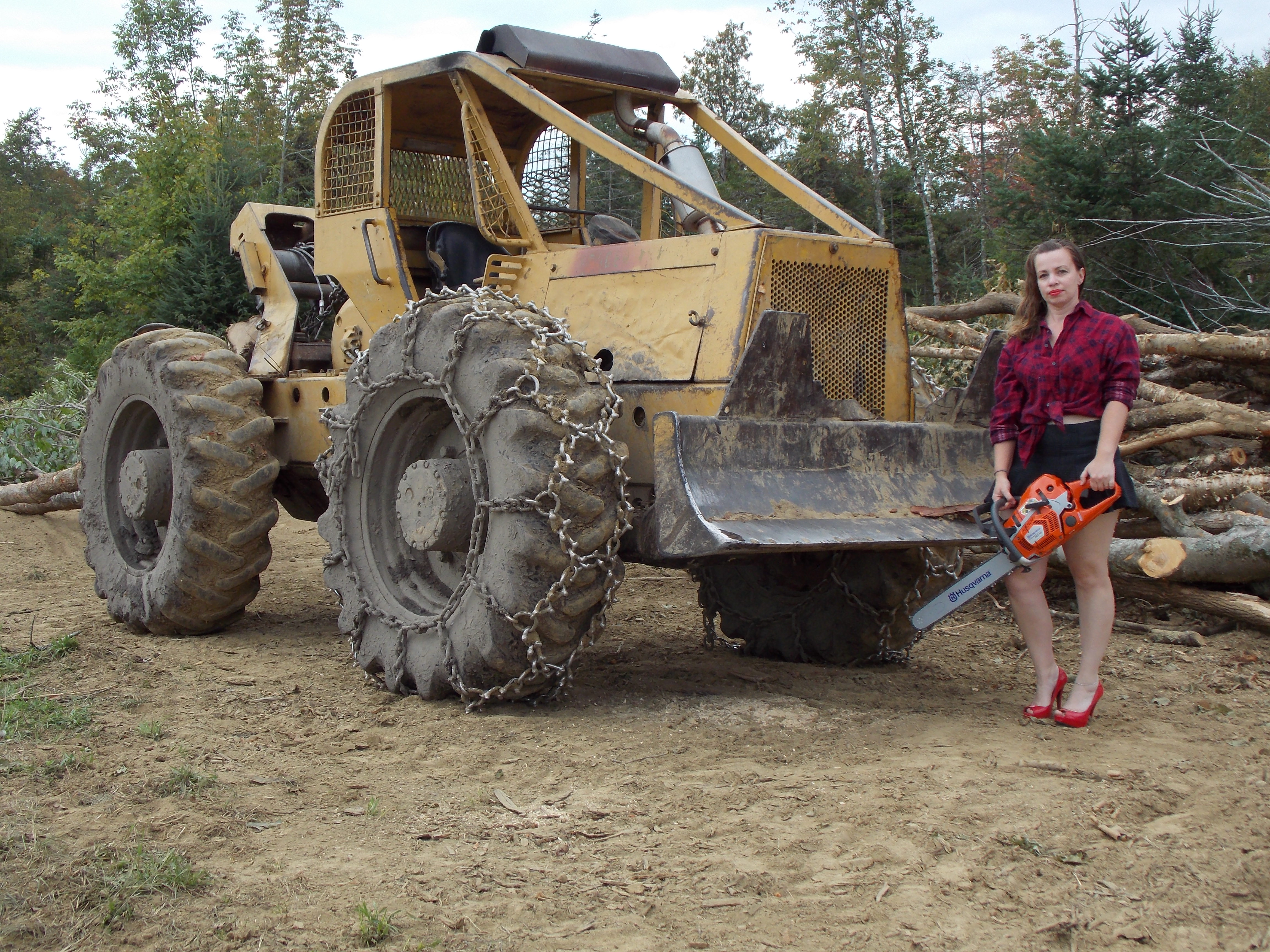

One of my greatest joys when I got my bigger tractor - I no longer needed chains. Yes, chains on all four and you can climb a wall. Otherwise - they can be a real PITA.
I disagree with this wholeheartedly.
Even the biggest tractors are made much more efficient (especially in the woods) when chains are added to the tires. They are a pain in the rump to maintain, but they are a necessity as well, especially anywhere the ground freezes and snow accumulates.
LouNY is indeed correct in that ladder, or double diamond, ice studded chains are the best; partly for ride quality, but also in reducing breakage. We used to run ring chains, and some loggers still do, but it is very hard on the rear-ends as the tractors constantly slips-grips as it is pulling/pushing. I dislike them.
Myself, where I put chains is dependent on the machine. I would NEVER put chains on the back tires of a skidder because all it does is make them rear upwards, so on them it is front-tires only, but on a tractor, I would only put them on the rear. A front end loader would have them on the back tires. A lot of it has to do with weight transfer.
These chains on this skidder are all worn out in this photo, but even in the summer, I run chains for added traction.
