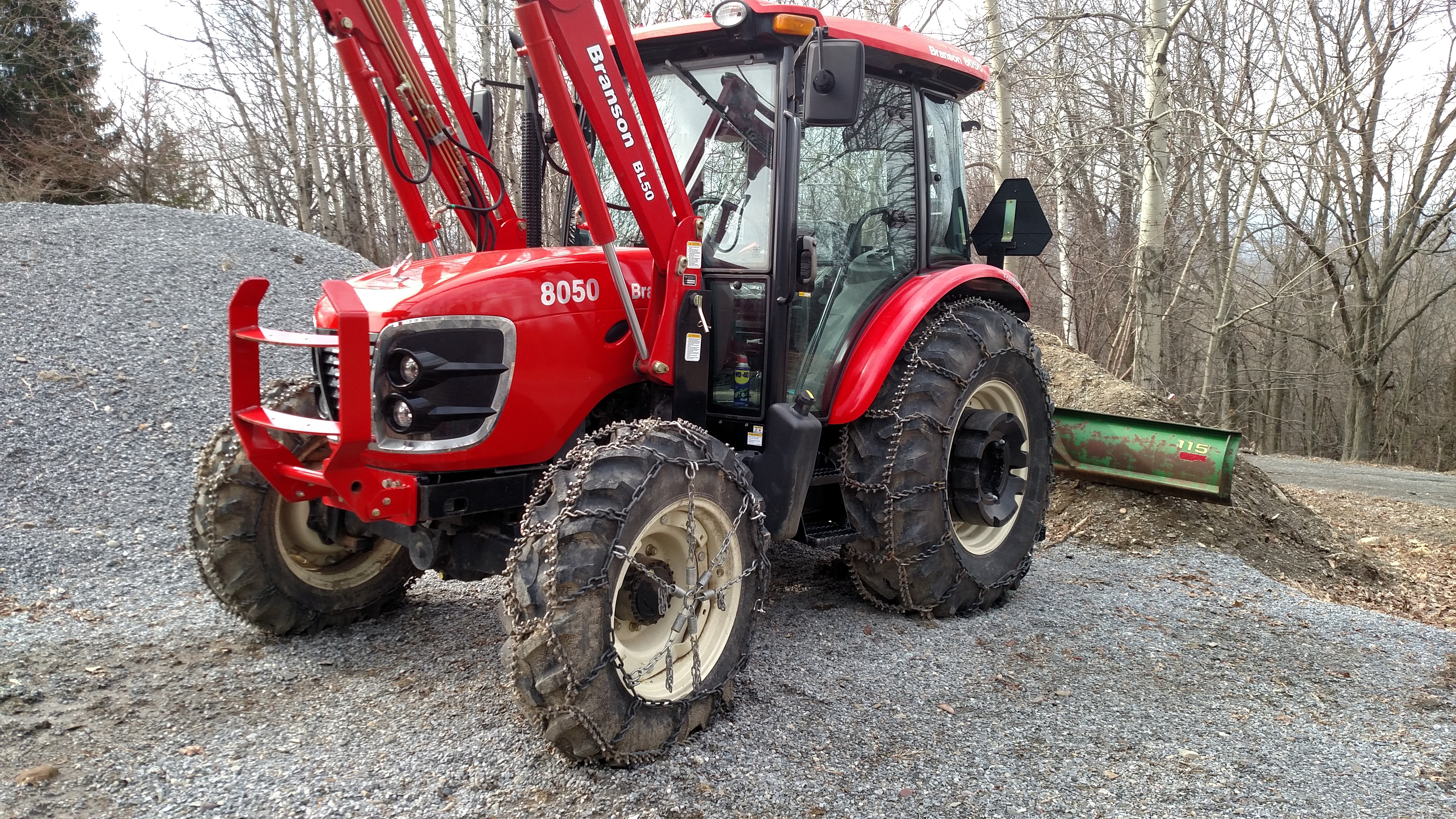

No, No, If you want chains that will work and last and offer a smooth ride get the euro studded type, such as these Aquilineョ Talon Tractor Chains.
Branson chains.jpg the rear ones are great, the fronts are a little to aggressive at times.
View attachment 535243 the rear ones are great, the fronts are a little to aggressive at times.
Your chains are indeed very good but also carry a price tag 2-3 times the amount of what I'm talking about. The truth of the matter to address your "no,no" about chains is that any chains and I mean any, are a big plus in the traction department.
I do not know how the op feels about ride comfort. I don't care as mine are seldom on a road surface and these ladders are not so bad at speed at all.

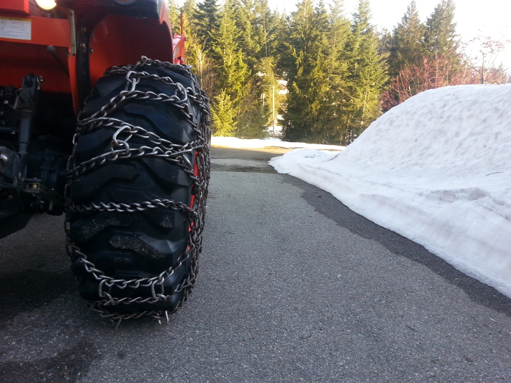

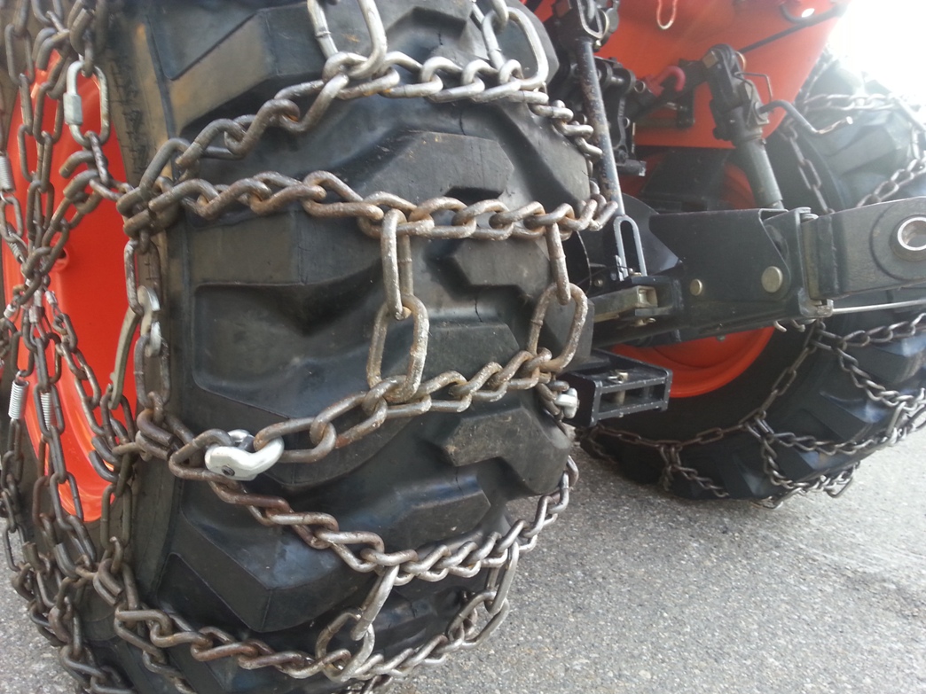

I had a large end-gap (4-side chain link gap) on my now H-pattern (formerly DUO) chains which I filled with a straight cross chain as you suggest. After a while the chains would shift badly at the end gap. I solved that by adding another DUO pattern across the end gap. The photos are in the thread referenced in my post 3 above but I'll post them here:
Chains with straight cross chain at end gap:
Replace straight cross chain with DUO pattern (left tire), right tire DUO pattern not yet added:
That stopped the shifting problem and improved traction/ride over the end gap.

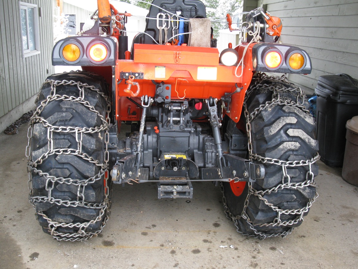

I have much the same issue with the chains on my L2900. Big gaps between the crosspieces. No real traction issues...but man, that ride is bumpy as heck.
