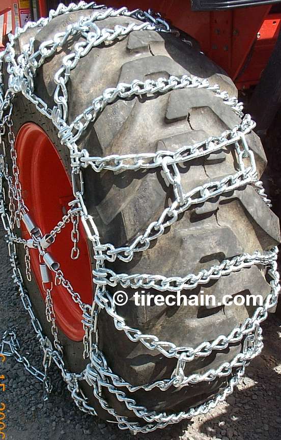

Gizmo - I had the same problem as you with the same chain and tire combo.
I just ordered some duogrip cross chain sections from Tire Chains.com:
Tire Chains Cross Chains
My chains will end up looking like the chains that davitk posted.
The new cross chains will be cheaper than buying a whole new set of chains.

Even quicker than davitks post, if you can't weld the links together in the center then ,go to TSC or Harbor Frt, or any good hardware and get a bunch of "hammer shut" repair links. They look a lot like a keyring thats been spread open,they were originally designed to repair crosschains that broke and needed a quick fix. We used to build our own chains, by putting together old busted ones with repair links. You slip them into two cross links in the center like davtiks pics and hammer them shut.(got to be on a hard surface). They will last forever on a tractor.

I had a long chat with the boys at TireChain.com and they do not recommend the Duogrip chains for my use. Since my venture with the horse manure the chains and tires have cleared packed in manure and the chains are back to riding more on top. TireChain.com boys said I will be fine come winter and pushing snow. I guess the problem comes with not enough tire on the ground when on hard surfaces. (too much chain).
It looks like the tire guys made yours just right to be wrong for your tires. BTW, I disagree with the tire guys. I think you will have the same problem with snow, and I have some experience as we've got 4 tractors on the place - all with chains. I don't care for lugs myself unless I'm farming. Industrials or turfs with good chains give you the option of traction when you need it and floatation when you don't want to tear up things or compact the soil.
Your chains are not a big problem. Either add more cross chains or connect the ones you have into an X pattern. Either one is easily done; you've already done the hard part. Or you could just use them as is and hope the rubber part wears down faster than the chain part. :)

if you're thinking of adding more cross links, as suggested, V-bars would be my choice ...but that's gonna make the chains mighty heavy.
Still, if you choose to do so, you should investigate: Large Repair Pliar
Also, if you use 4wd, note that you don't have chains on the front, which I find quite useful for enhancing engine braking as well as go-power...and, steering. I you decide you might want front chains, get V-bar and see if that doesn't fix your current problem...otherwise, with your tires in the manure, 4wd wouldn't seem of much use.

Would it help to not have the bungee cords and let the chains go a little looser so they can move somewhat. That way they may get moved up onto the high side and not stay in the grove. The natural rotation would allow them to flop out. Not too loose mind you. But worth a try and cost nothing.

I agree with the recomendation to weld or use a quick link to join center of adjacent cross chains in the center. I have both v-bar and smooth chains, they preform equally well on ice but the v-bar digs up the hot top and concrete more. I also agree Ags are the only way to go but thats a whole different topic.
