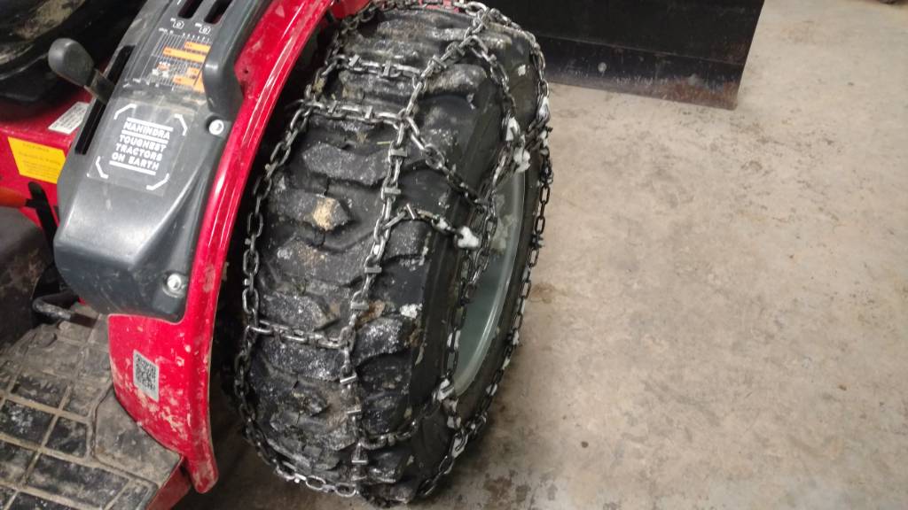

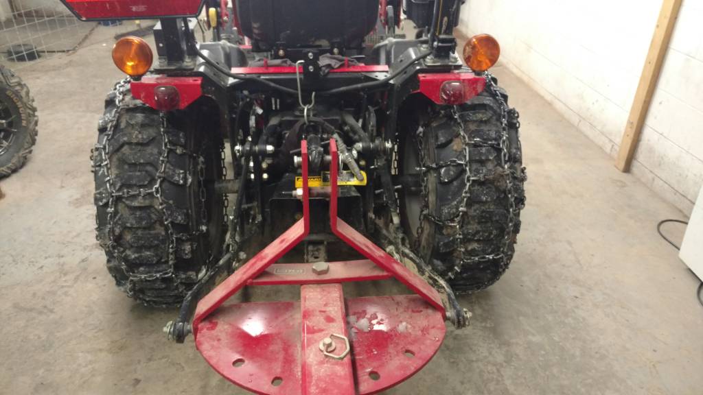

My chains are euro stud type with cross links at every 3rd link.
Very smooth ride and extremely rare to slip as there is always at least 2 cross links in road contact.
Basically home made.
