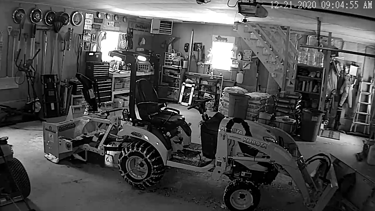

I have a 2380 with turfs and run rear chains with no problems. Use a tensioner and tywrap any loose link IMG_0160.JPG

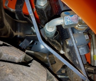

Have a new SCUT! BX2380 with R4s and 2 inch wheel spacers. Only real concern about chain clearance on the rear wheels are on the driver's right (starboard) side. There is what looks like a plate to protect a bunch of hardware related to the controls located inside the right side of the fender towards the front (~2 o'clock position). See attached image. ~3cm/+1 inch of space. Would like to go with the square chain design that tire chains dot com sell, but the links if sitting on the tread ribs could project 1/2" above those treads. Bad idea? Heavy duty standard 2 links provide the most clearance, but guessing less effective on really ice hard surfaces? Plan are chains on the rear only with chain tensioners. If steering issues or too much front wheel spin will add some iGrip studs. 3pt mounted snowblower and FEL bucket or snow blade in front for snow removal.
Those tiny SCUT front wheels and tires seem to provide minimum and maybe not enough clearance for the steering hardware. Long time ago I was told by the dealer of my NH that chains on front only was a bad idea. Potentially too much load on the front drive once the bare rear wheels start to spin.

2" spacers on the wheels. When attaching the 2-link ladder heavy duty chains I noticed on the inner side of the right wheel well a couple unshielded lines. So focused on the minimal space in the posted image I didn't really notice the inner lines. Looks to be more than adequate clearance with the wheel spacers.
