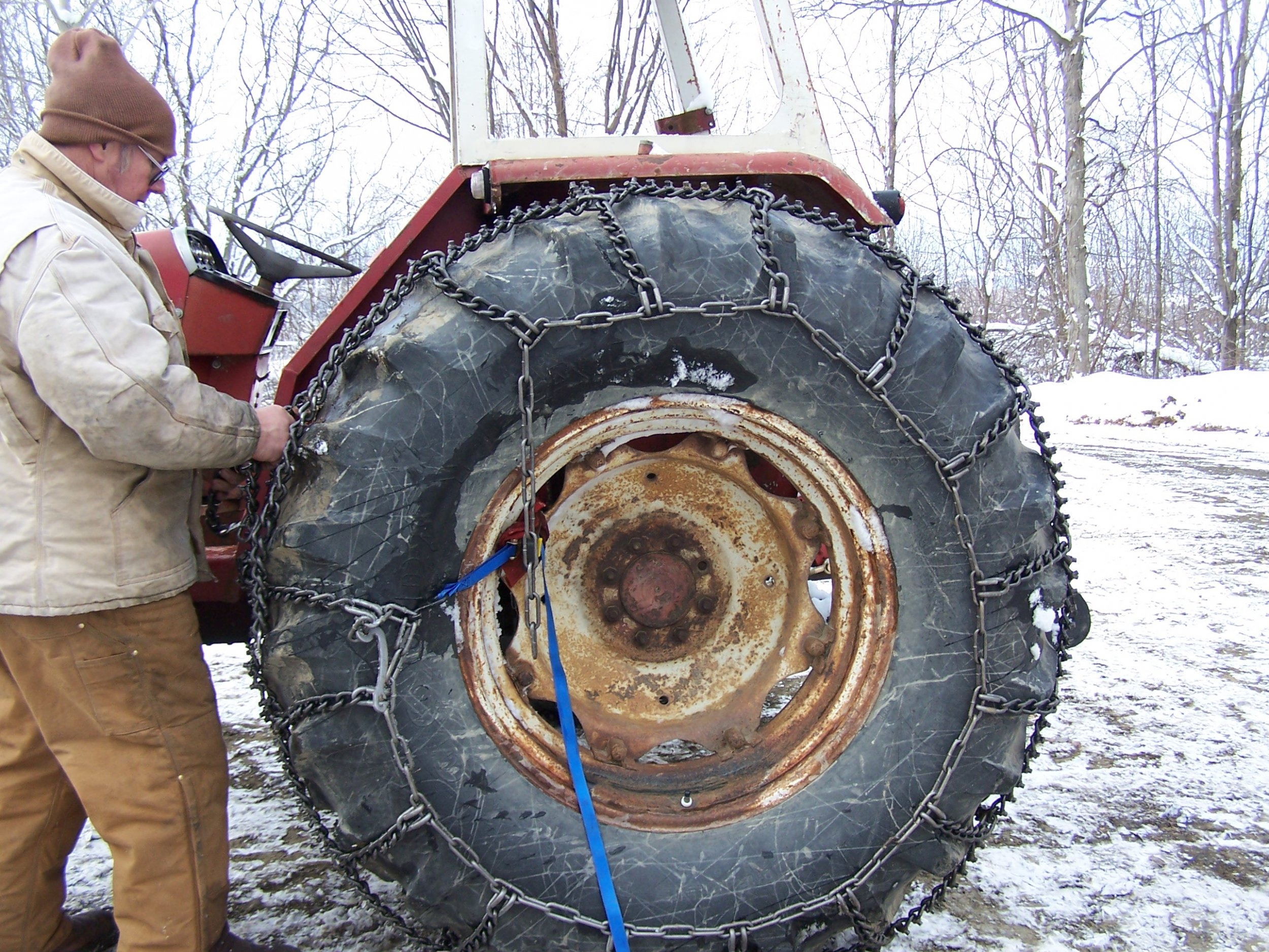

At that size, you're going to be in 5/16" or even 3/8" chain, so do mind the weight. I kept my lefts (front + rear) in one milk crate and the rights in another, and it's all I can to carry or drag them in and out of the shed some days. Getting them on/off is a chore, but one that goes more smoothly with practice.
/ Tire chains #10
If you "drive" them on it's much easier.
Mounting tire chains
