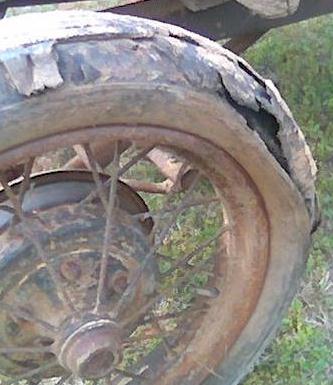

And plus all the above we need to sometimes adjust for the tire condition too. This one actually has air pressure above atmospheric and the trailer it was on was pulled to the auction.
I couldn't see the numbers and I couldn't hear the leak if it had one. And if I were told on TV some idiot would be beating on a 55 gallon drum in the background so I couldn't hear. Come on society, cut us old folks a little slack.:laughing:
