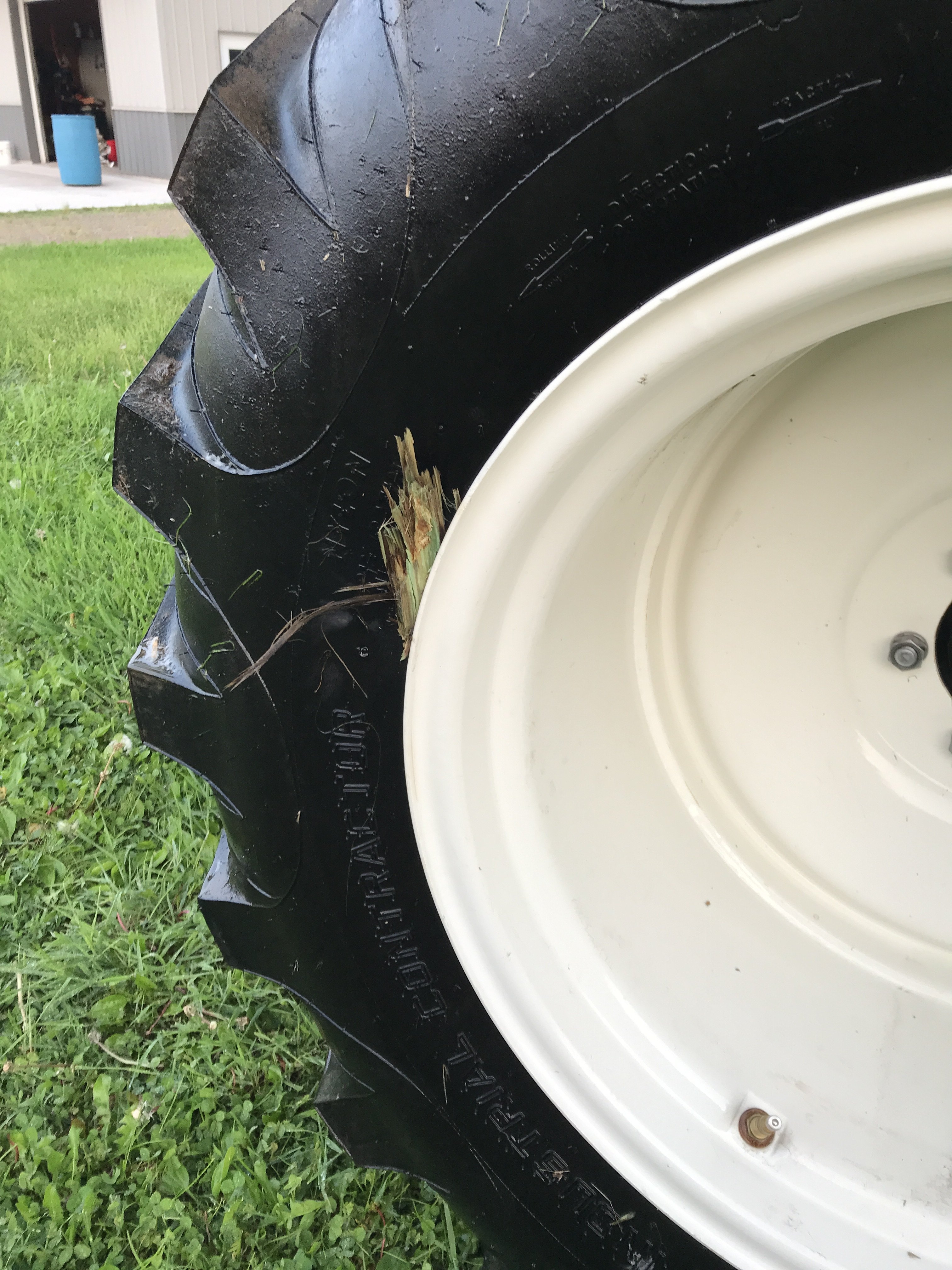

Was mowing some brush with Bush Hog type mower, knew perfectly well I was driving over stuff I shouldn’t be driving over, after the job was completed I wanted to to wash the mud off everything that’s when I noticed some fluid had leaked out and the piece of brush stuck between rim and bead. It didn’t seem to be leaking anymore but I wanted that stick removed so took a ride to local tire dealer and showed them the picture. They said they had another tire job in my area today and could also stop to fix mine, cost me $180 but I’m thankful things didn’t turn out a lot worse !
