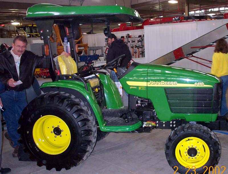

Incidentally, this picture (originally posted by JMIII) is what got me started on the quest for larger R4s. I noticed that the distance from the rear tire tread to the fender lip was much smaller than the gap on my 4300 with the smaller R4s. Being a fanatic about such things /w3tcompact/icons/crazy.gif meant I just had to get the larger wheels./w3tcompact/icons/smile.gif

For comparison, here is a picture of my 4300 with the smaller R4s.
   / Tire Sizes -4310 option #6
Here is another angle which probably shows the size difference better.
