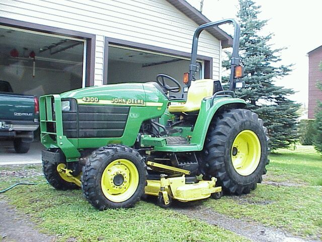

The change in tire size results in about a 10% increase in ground speed in each gear. Since I have a hydrostatic transmission I don't notice the difference at all. I mow in B range and I just don't push the pedal down as far to get the desired ground speed. I have run it in 4wd and the lead ratio for the front wheels seems to be the same as it was with the old tires. I do not have any difficulty in shifting in or out of 4wd due to drive line windup. As promised here are some pictures with the new tires.
   / Tire Sizes -4310 option #17
Another...

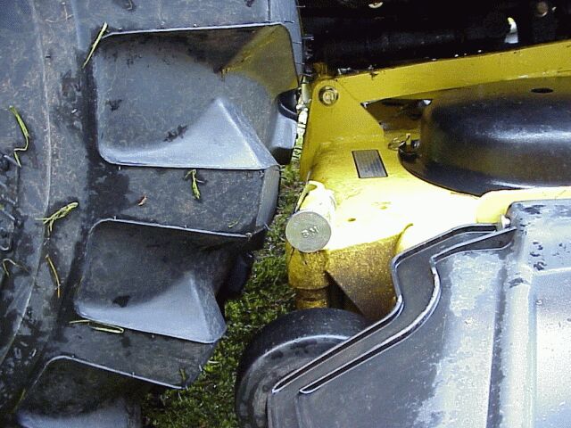

Here is a shot of the mower deck in the fully lifted position showing the "adjustment" I needed to make to the rear anti-scalp wheel to clear the rear wheel. I could have also re-adjusted the lift links so that the deck would not lift as high and not needed the trimming. Since my main goal in getting these new tires was to gain ground clearance I decided to trim the bracket and allow the deck to be lifted fully.

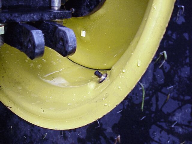

The new rear wheels do not have the valve stem guards that my old rims had. They do, however, have these really short brass valve stems. I think that they are far enough out of the way to avoid most brush and debris.

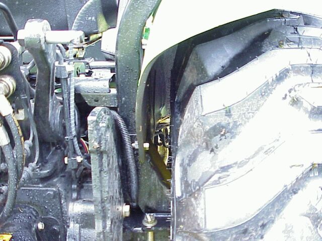

There might still be room for rear chains with the new tires. With the rear wheels in the wider position I have about 2 inches of clear space between the tire sidewall and the fender. The narrow position would be about an inch closer to the fender.
