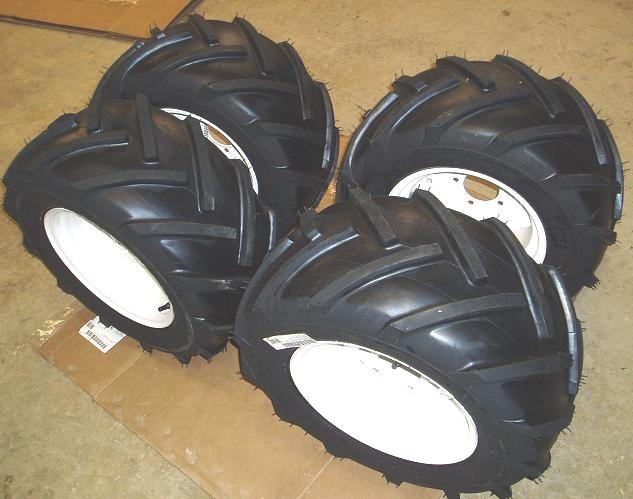

Carlisle gave me info for the rims. so i could be sure to get the right ones
My cost for a full set of shoes
4 each super lug 4 ply
Plus 4 rims to fit the 422/425
Total charged to the credit card including shipping = $428.44
This is Per J.J.
Some other things you might consider, the shortest valve stem you can find, and about a quart of slime in each tire. Bar lugs pointing forward and stem to the outside. good luck

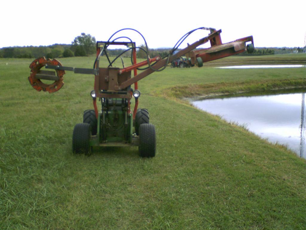

Take a look at the tires in this pic. I have no problem doing this.

Your 422 must have better tires than my 425
-OR-
Our decomposed granite 'soil' is more abrasive.
After 310 or so hours, the front bar tires have about 1/8" tread, rears 3/16" with a combination of loader work and mini-hoe work.
Mark H.
