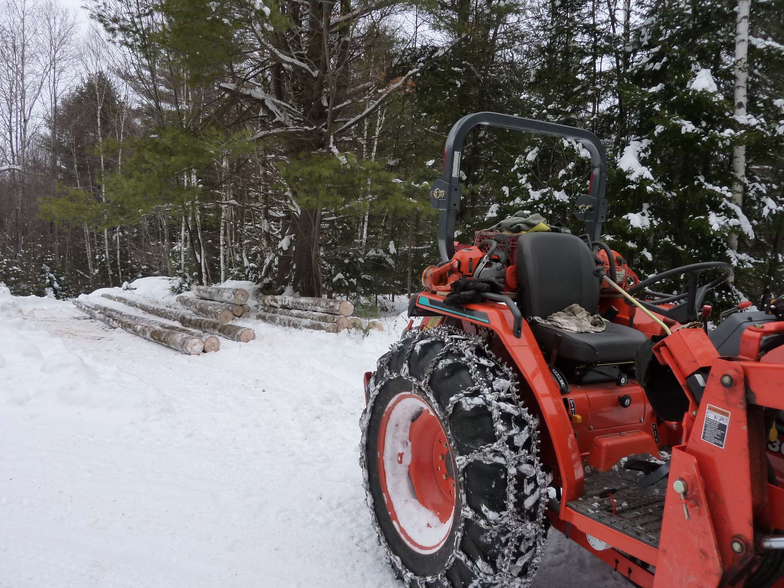

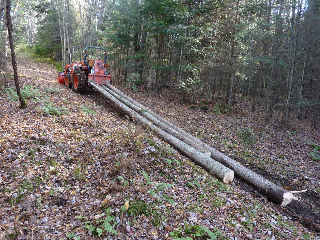

You will want loaded Ag tires for the mud and if you have any snow/ice, rock/ledge, or roots to go over you will also want chains I think. Ag tires work great in soft dirt but you would be amazed at how slippery a big wet root or flat rock or ledge is, especially in a wet spot, if you are pulling a load or going up hill. There is nothing for the lugs to grab when you get on something smooth. I could not go on this trail when it is wet w/o chains unless I stood on the dif-lock all day. And I really like this style chain.
