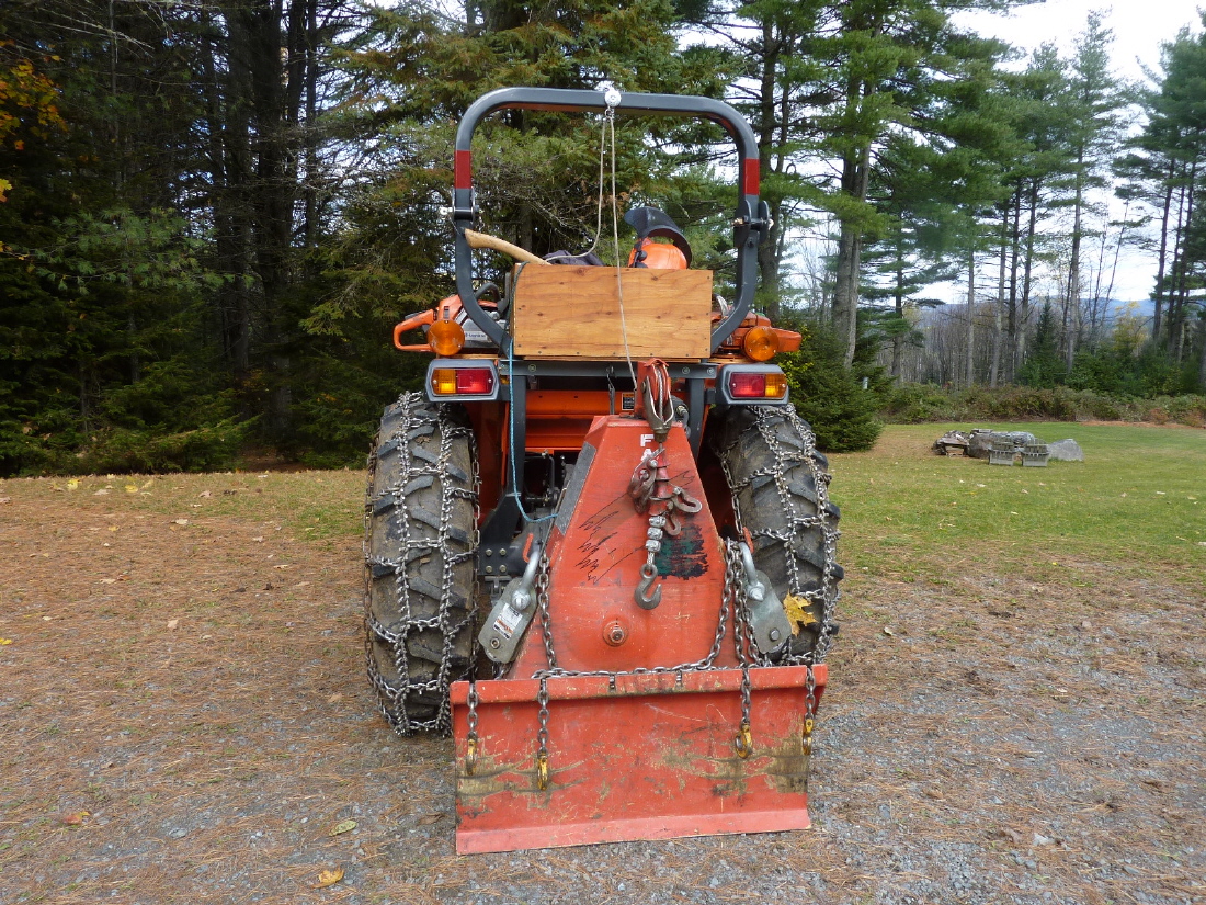

My chains are made by Tellefsdal from Norway. I got them from my tractor dealer, who is now out of business, about 10 years ago. I am not sure they are still available but there are other manufactures - I just can't think of a name right now. When I do I will post it. A search on TBN for chains should turn them up. The chains are studded "H" pattern and are great for Ag tires because they don't fall down between the lugs, they stay on top of the lugs where they can get a good grip on the surface. You can't beat them on ice.
I did not need spacers - plenty of clearance on my tractor with Ag tires.

Aquiline is one that I just thought of.
   / Tires for steep muddy hills #26
Aquiline or Talon and perhaps others. Once you have a set of those on it matters not if they are on R1s ,R4s or turf tires. The chains do all the talking. I was down in the lower woods today at 10 degrees F pulling logs up a fifteen percent grade on snow. I wouldn't even leave the door yard with anything less on the rears with a full load of beet juice in them.

Yes those will work! Nice rig! Nice chainsaw!!! :D

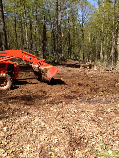

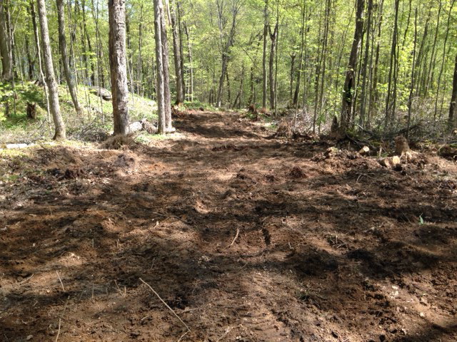

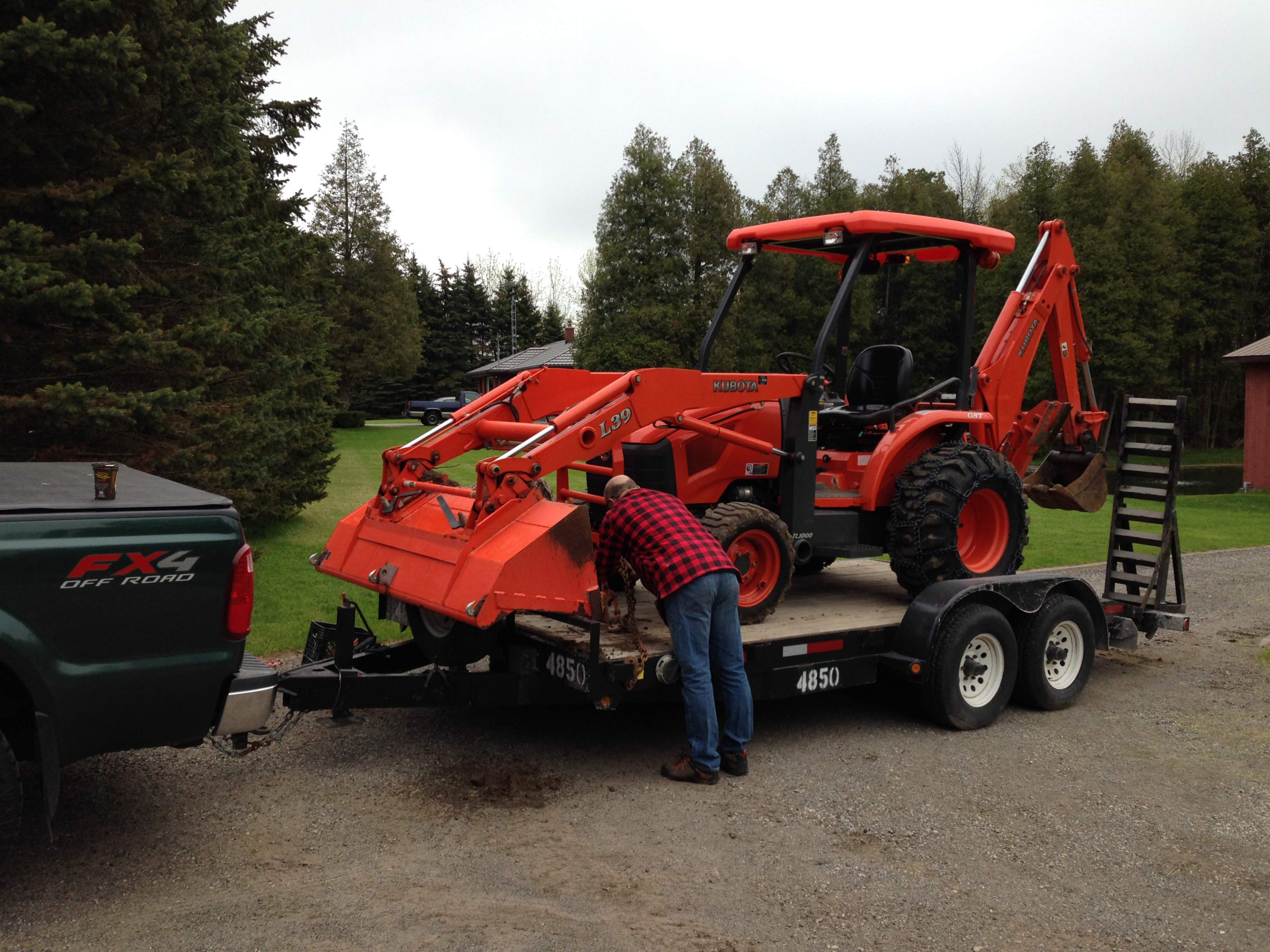

Got started this last weekend - lots of stumps and Black-flies!
