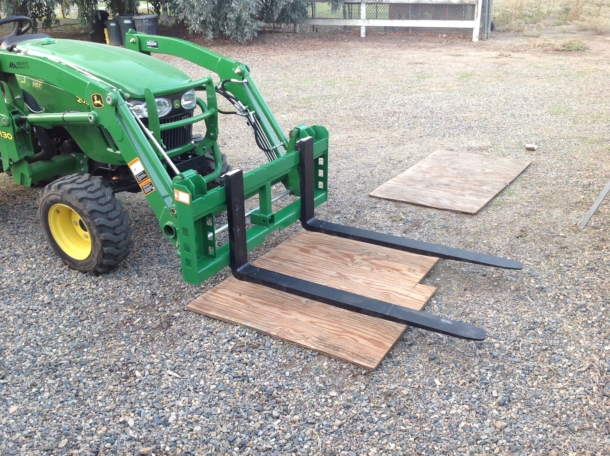

I have been happy with their 3pt pallet forks and bucket clamp on trailer mover. I also picked up their stump bucket however I have not tried it yet (wanted it to pop out rocks not stumps as sort of a pore mans backhoe). They have excellent pricing however you have to keep in mind it is Chinese quality so welds etc. may not be as good as USA sourced. For my purposes fine.

I have their ballast box, FEL Forks, and JD QA plate. You should first understand why your getting such a great price compared to USA implements, they are made in China, the welds are ok not great, the packaging is sometimes poor and quality control can be hit or miss, that being said, if you own a compact tractor the likelihood of tearing up the implement is rather slim so the money your saving outweighs the fact that you can always touch up a weld if need be. The Forks work great and far exceed the lifting capacity of my FEL and will last forever, I bought one of the first ballast boxes before they had a design change so I can't comment on the new ones but it's a box you fill with concrete and works fine, welds not so great. The JD QA plate is built well, nice and straight and a great price, welds look good. So understand if things are not perfect that's because the money your saving and I'm ok with that.
