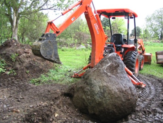

I second that. Big rocks are a big problem for a small machine. Big rocks are not a problem for a 48/39. You'd be amazed the size of the rocks I've moved with the 39. Here's one for you.....This beast was right in the middle of where I'm digging my road. It moved it, didn't like it, but it did it. /forums/images/graemlins/cool.gif

Thats a good way to BREAK a backhoe for sure. Be careful. /forums/images/graemlins/shocked.gif

Nah....It's not a big deal for the mighty BT1000. Breakout force is rated at just under 6000 lbs. This is not a hoe attached to the rear of a CUT with a subframe design. The stabilizers are massive.
That rock is big, but the hoe pulled it right out of the hole. Now the loader was none too pleased, but she performed as directed (barely). I had to skid the rock into place, mainly due to its size and the fact that I couldn't get it into the bucket far enough under the pivot point. That's the problem moving big rocks with a standard bucket. Forks are necessary for rock lifting.
