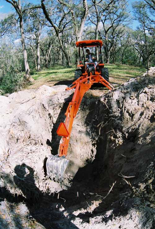

Hoe Down, this is what I'm talkin' about! /forums/images/graemlins/blush.gif
   / TLB for home construction and 8 acres #43

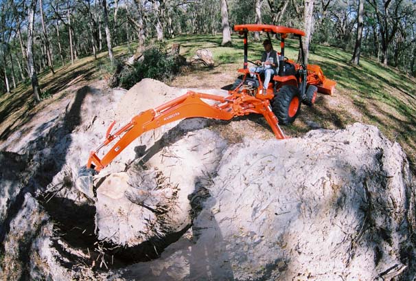

Stump-B-Gone /forums/images/graemlins/grin.gif
