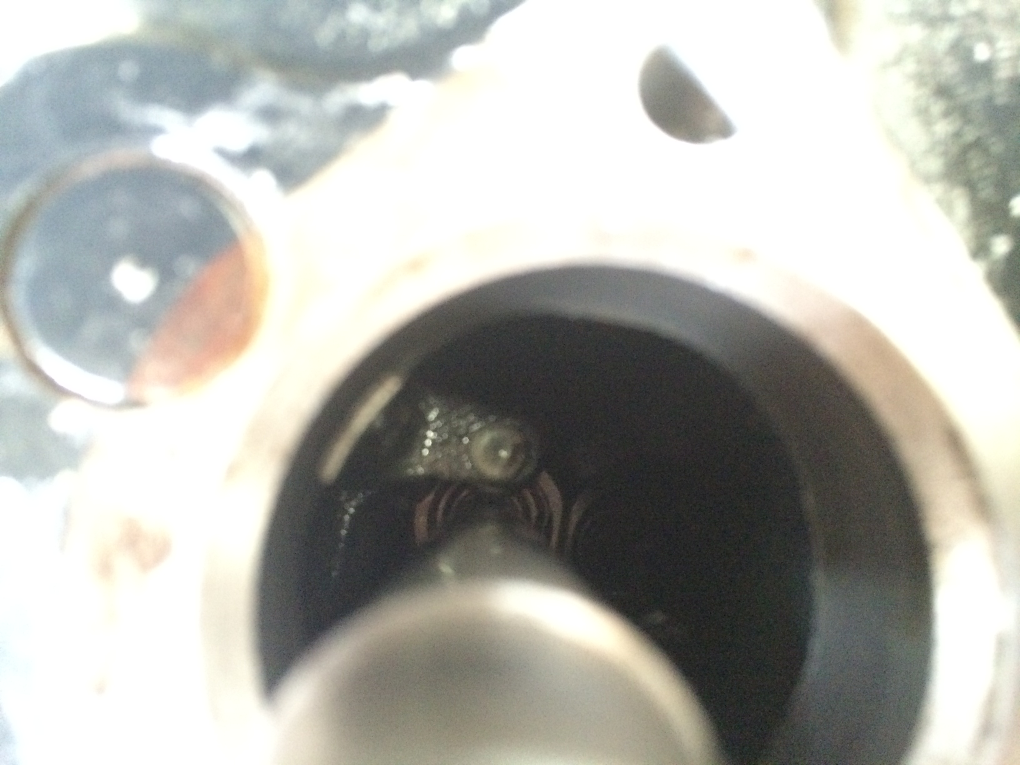

Place position and draft levers fully forward/down before removing the bar.
RickB is this required for the draft sensing control lever that rides on the bar? Is the correct position of this roller on the front axle side of the bar? draft sensing follower.JPG

Not really. There isn't much to it. Rotate and tap/pry out.
