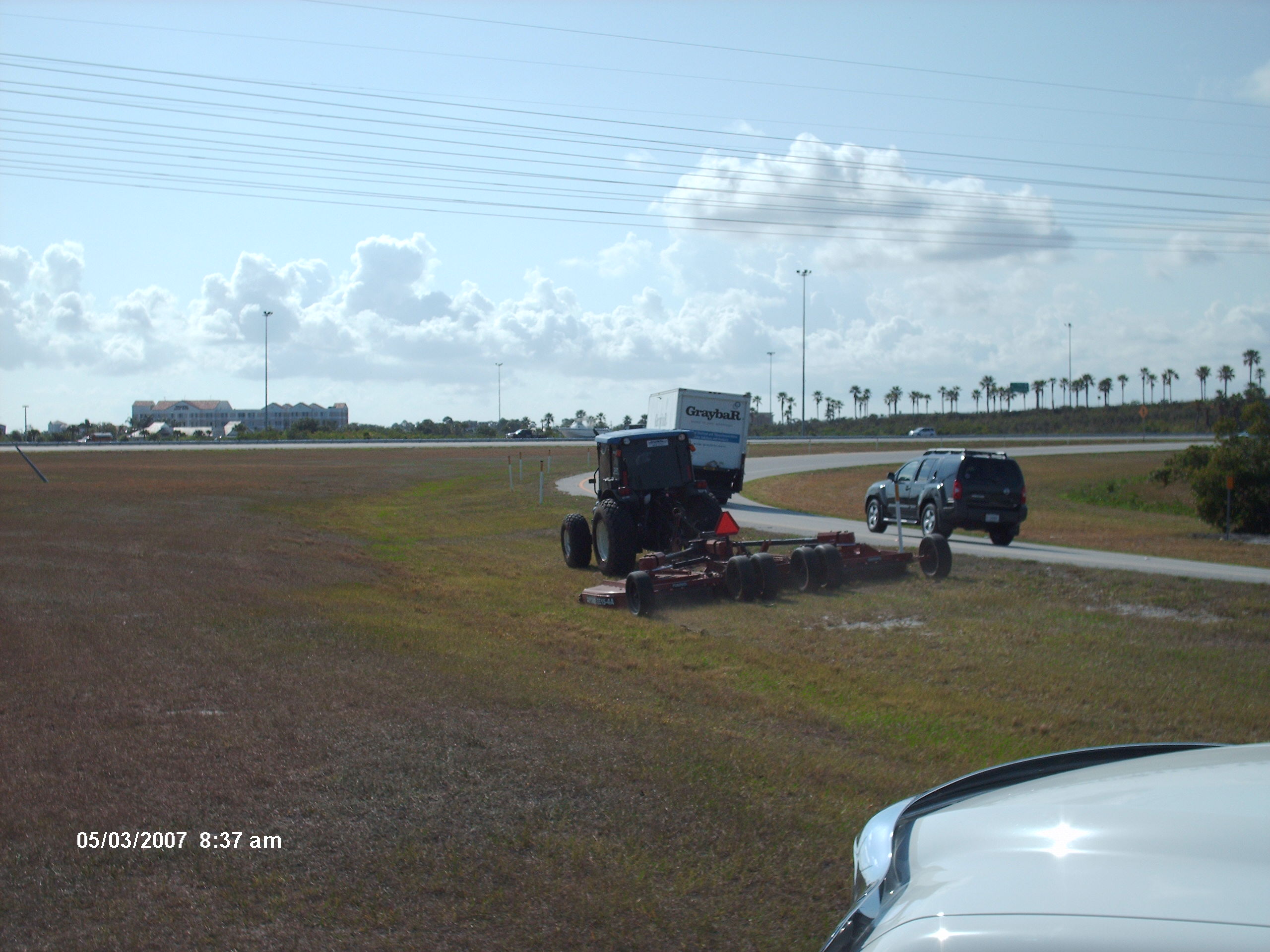

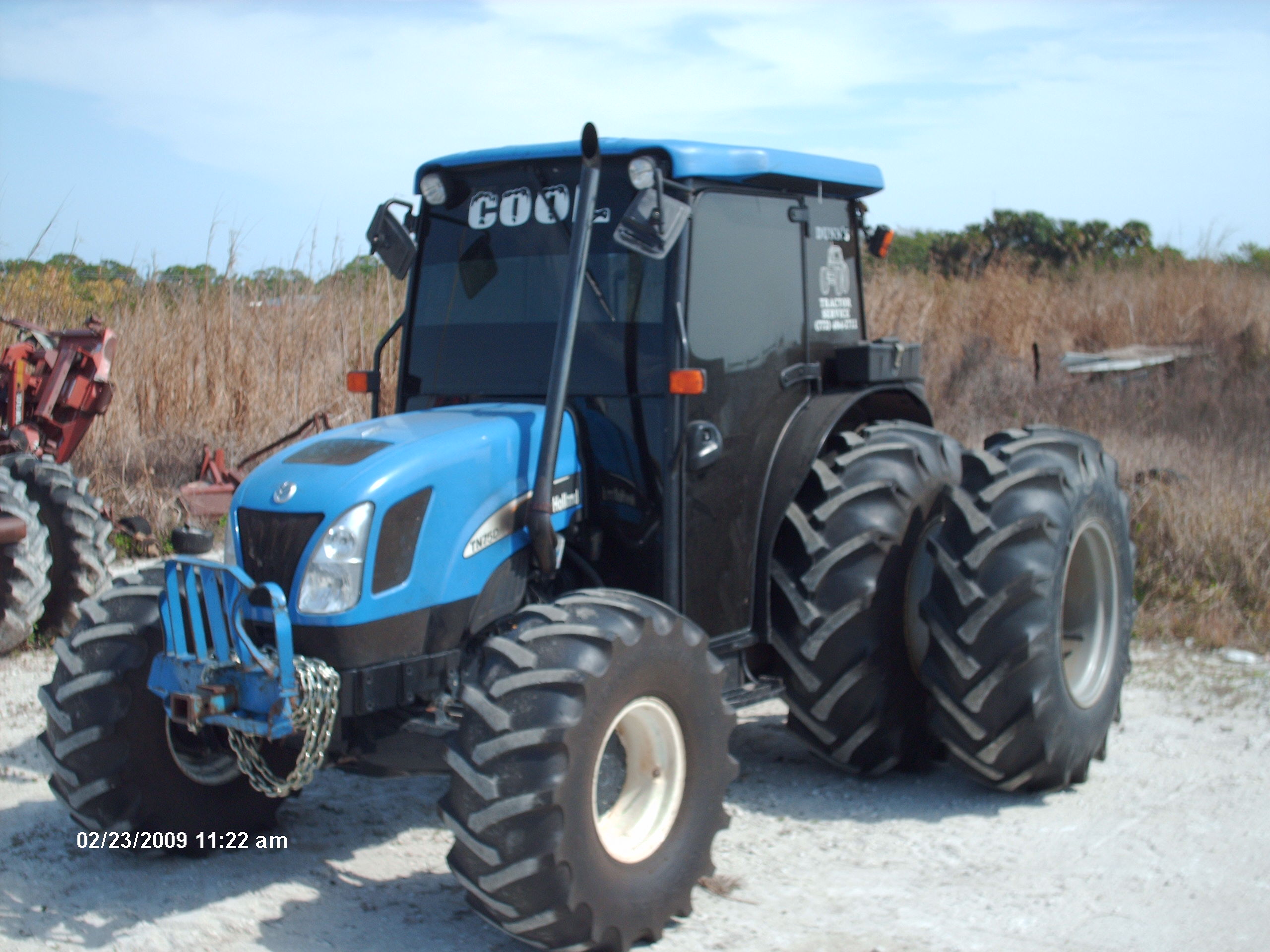

we have 4 TN75 all 4x4 with cabs..we use them for grading..light clearing the one with loader..finsh mowing in parks...light/rought bushhog with 7ft..8ft..15ft batwing..also 2 are set up with duals wheels for slope/canals mowing.So yes I like them and looking at getting another one.We have put them in places they sould not be but my saying show me the money. And before anybody say something we stay on top of all maintance because we do put the in places no one else will.As anything bad just the normal wear and tear..good luck

Howierd3866:
I like your TN with the duels, what size and brand are the front tires on that tractor. They look like forestry tires and wheels.
Thank you
/ TN75 info #10
the rims are factory new holland set up for a grading tractor. All I did was change the front tire from R3 to R1 type.I will check size and brand when I get back by that tractor.
/ TN75 info #11
sorry just now got a chance to check on this for you. the tires name is Amercian Farmer and the size is 16.5L x 16.1
