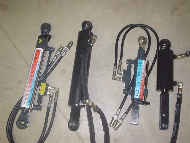

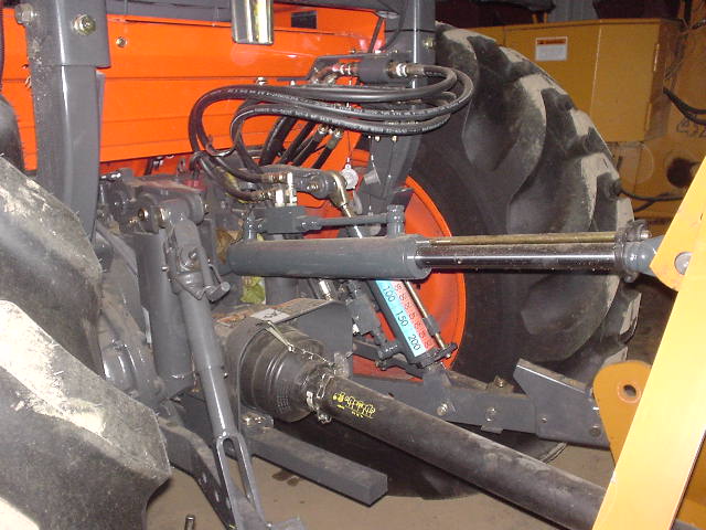

I decided to replace the Kubota system with Integration Engineering's cylinders and hoses. The valves are Kubota". A picture is attached.
Their cost was $554 plus shipping, no sales tax, you install. Shipping was via UPS, a short distance, $39. (ouch)
These cylinders are 2 3/8" diameter vs 3 3/8" for Kubota. I asked for 1/4" diameter hoses instead of the standard 3/8" and they route much better without restricting flow enough to affect the cylinder. There is no appreciable leakage with these cylinders. The products appear well made. Product support is excellent but you may have to leave a message.
This Integation Engineering system is still expensive but I would definitely get piloted check valve cylinders from somebody.

Another view of Integration Engineerings's system.

Side by side of both systems. The diameter difference looks much bigger in person than it seems in the picture.

It appears from the picture that the IE cylinders would give you more travel than the Kubota, at the expense of a longer top link. Is this true? If so will the longer top link be an issue?
   / TnT: Kubo ata's vs Integration Engineering, Part 2 #6
Re: TnT: Kubo ata\'s vs Integration Engineering, Part 2
Knowing how my top link works, I personnaly would not go down in piston size. There are times I use every bit of what I have. You can't really get more travel without sacrificing the overall length unless you had a telescoping hydraulic system. I still see no need for piloted hydraulics myself. The 1/4" hoses will work very well as you mentioned. The price is good.

Kubota's, IE's, and the Kubota original equipment turnbuckle are virtually the same length, extended and retracted.
Additionally, one extra feature to IE's SIDELINK is you have several inches of length adjustment before you mount the sidelink. The piston rod is threaded and the top eyelet is an eyebolt. This adjustment mechanism does not reduce the cylinder stroke.
