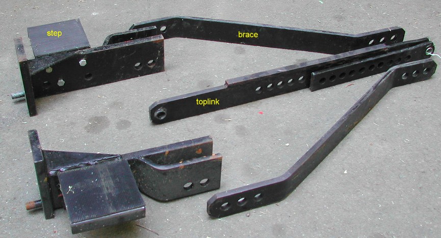

BEDLAM:
Here is a photo of the Woods 3pt setup you mentioned. The anti-lift
baces in the photo are 5/8" steel. It is one of several I have left over from
converting to subframes. One guy who uses the 3pt with his hoe on
a Cat 2 Case 480 has buckled the toplink and he did not use the
braces at first. Now he uses them.

dfkrug pointed out that A properly installed 3-pt hoe MUST use an anti-lift bracket to keep the 3PH from rising. There are anecdotes about operators getting pinched by a hoe that suddenly rises. I don't know if I have that anti-lift bracket. Can someone post a photo what that is supposed to look like?

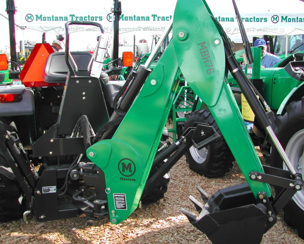

8561:
As far as I know, Kubota still sells its 4690 hoe, which uses the 3-pt.
They also state that you can only use THEIR 3-pt hoe on their tractors.
I confronted a factory rep at a World AG Expo about that issue and
he admitted it was not consistent.
Montana has openly stated their hoes were Amerequips, but they used
to have their own model #s. Old Montana hoe is pictured.
