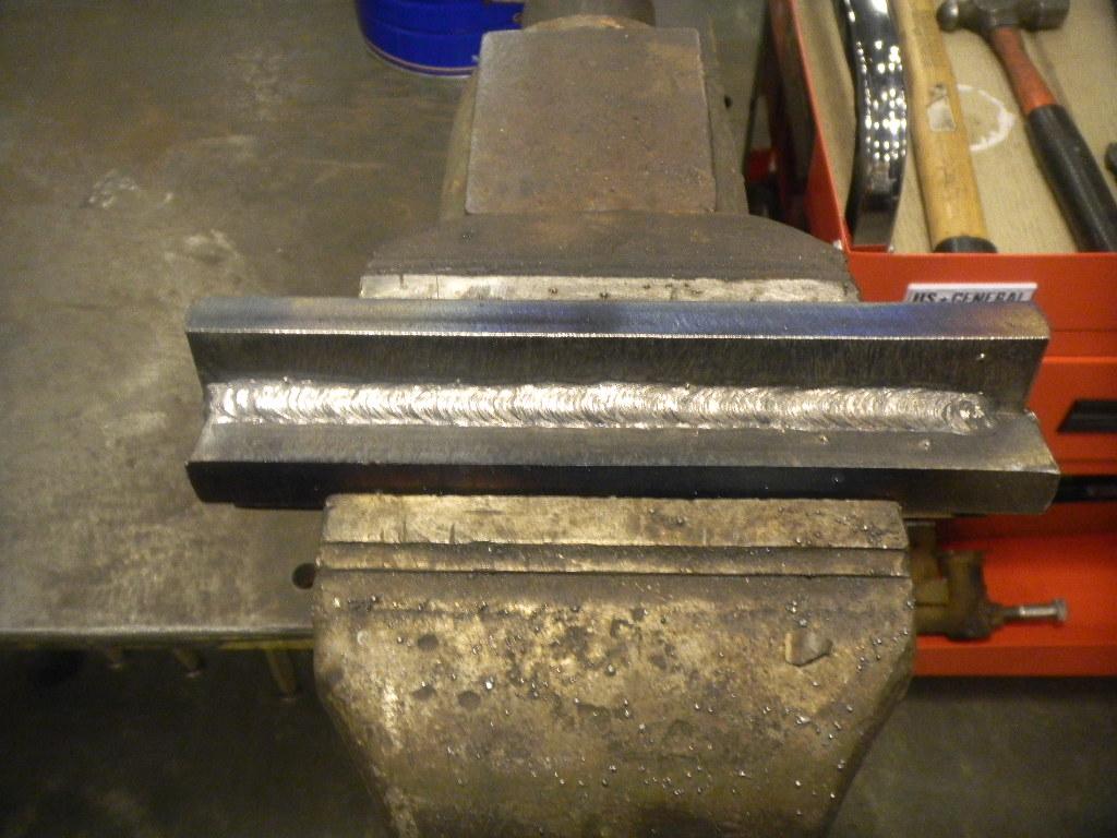

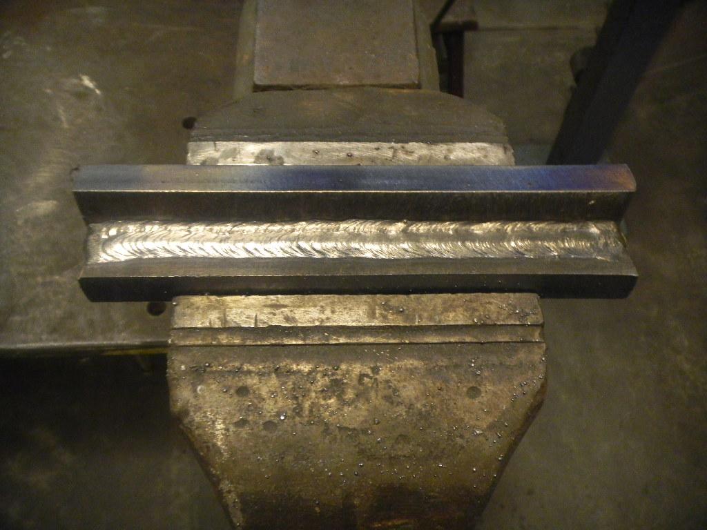

All I can say is that is darn impressive! (welder/Weldor):thumbsup:
Thank you!;)
It does pretty good with 7018 also. Even though this welder was built years before 7018 came out.:laughing:
