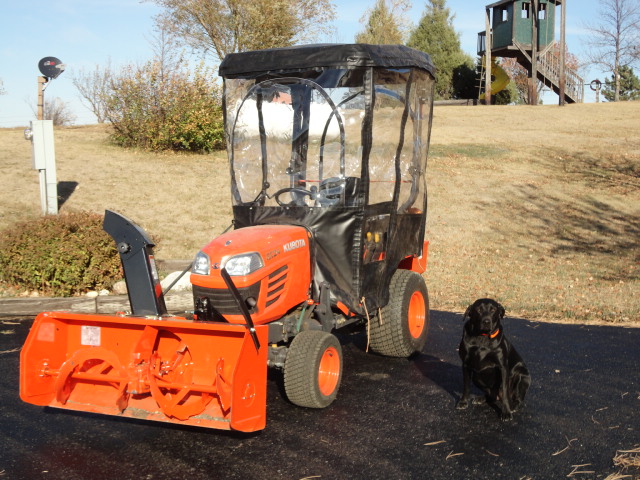

A side from the price difference. You have to decide whether you want a cab in the summer or not. I have a soft cab on my BX24 and it is plenty for me in North Dakota.

I take the Sims cab off my BX 2200 each spring I leave the front section, about 18" on the tractor year round and then attached to it in the fall. I do this by myself with the use of a winch mounted at the ceiling. I made a jig that attaches to all 4 corners of the cab and use it to lift the cab onto the tractor. I use the same winch to put on the front snowblower lift device. I did all of this yesterday it took me 3 hours to go from summer mowing to winter snowblowing. The Sims cab is steel and has a glass front and rear windows, with plastic doors, one opens the other is a not movable, it snaps into place.
They are calling for 8-12" of the white stuff the next 24 hours. The cab also has a heater I snowblow with a long sleeve shirt on, nice and warm.
